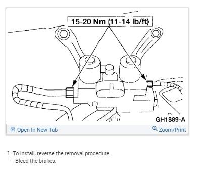

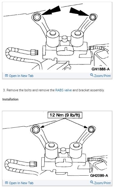

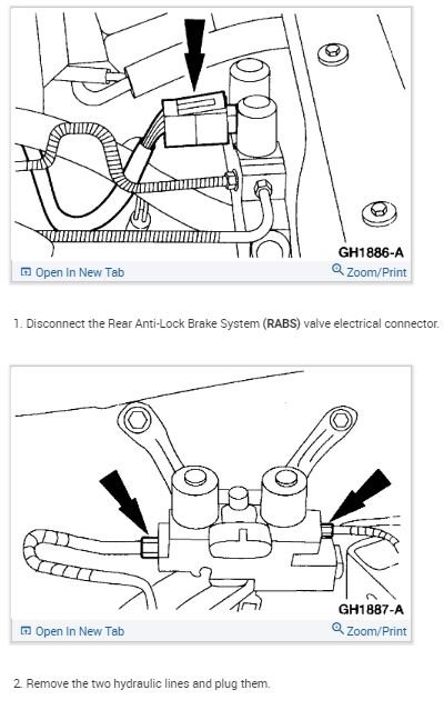

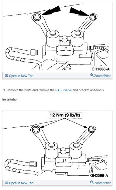

A common issue on these trucks is the RABS valve. Like 90% of the ones that I would get this concern I would run to my parts counter and get a price on one before I diagnosed it. Dtcs on these are not retrieved through the data link connector, but hopefully your mechanic knows this?
See the diagrams below for replacement instructions.
