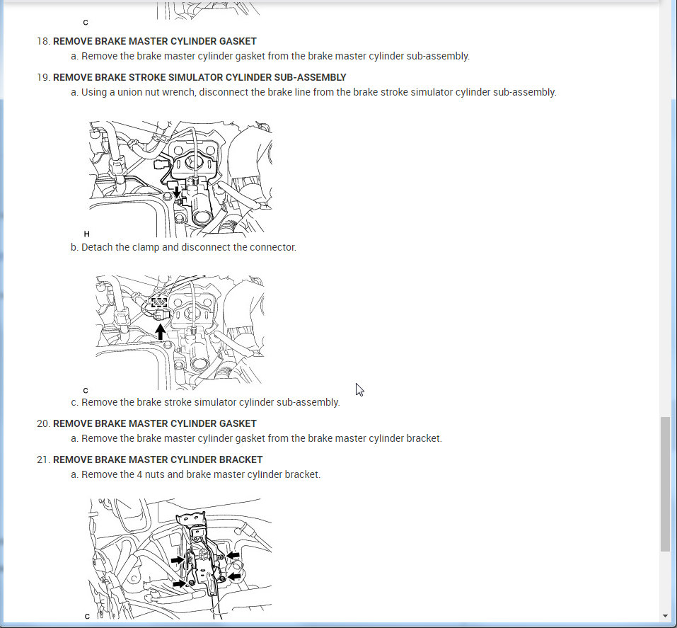

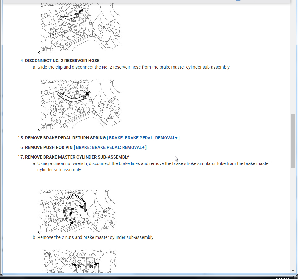

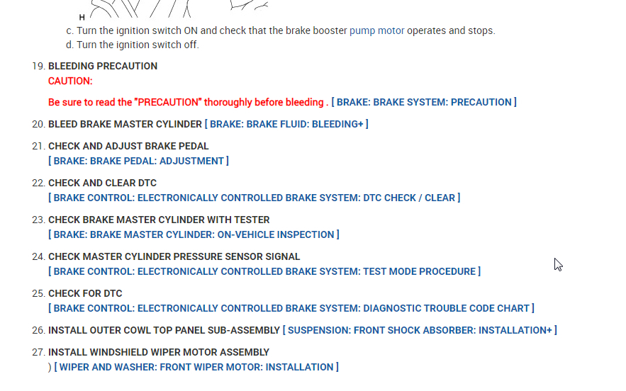

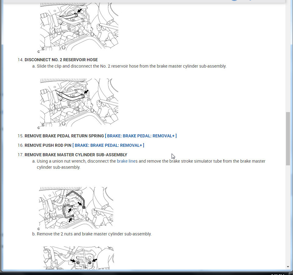

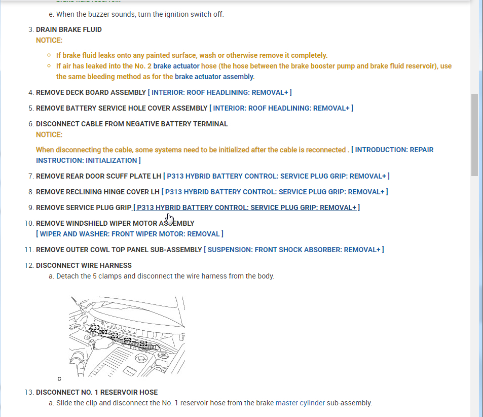

I see brake fluid leaking from the brake master can you help me?
Mar 1, 2017 at 4:03 AM
Experienced Mechanic
18,907 POSTS

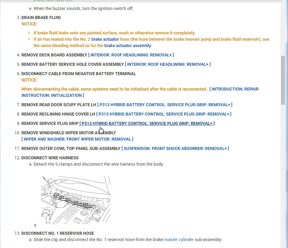

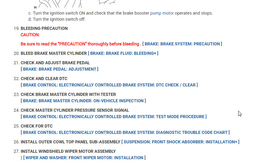

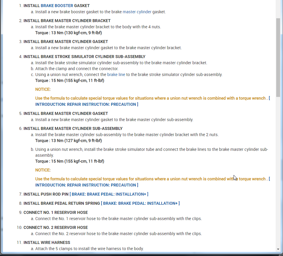

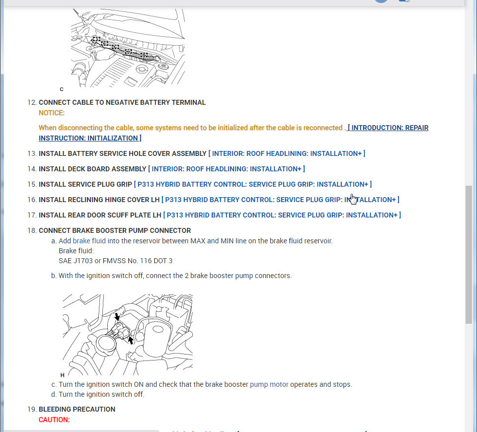

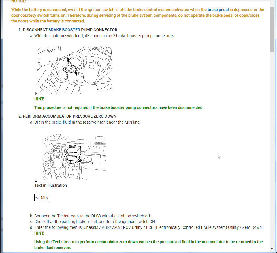

Yes. We can help. Here is a guide that will help with this:
https://www.2carpros.com/articles/how-to-replace-a-brake-master-cylinder
Plus here is a video on how to bleed the brakes as you will need to do this as well:
https://youtu.be/ye64wlARgcs
Below is the process from the manual that will help with this as well. Please let us know if you have other questions. Thanks
