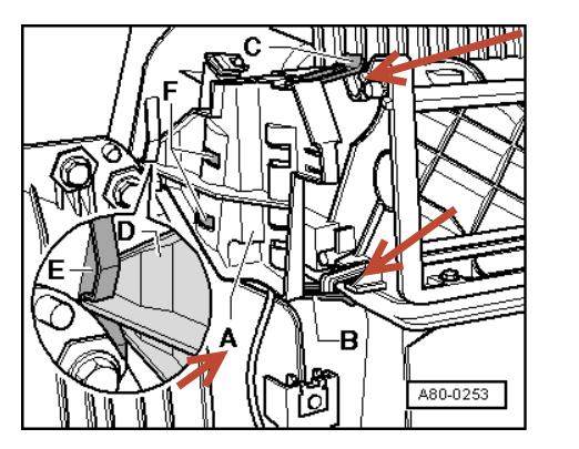

tring to remove vwrecirculation flap motor it have a bracket beside it one screw at bottom don't know how to remove
Apr 20, 2013 at 1:20 PM
WILLIE SIMMONSL
What all do I need to remove to get 2007 VW Passat recirulation flap motor out on the passenger side?
Apr 20, 2013 at 4:13 PM
HMAC300
  • 48,601 POSTS
the fresh air door if that is what I think it is can only be removed without difficulty in fresh air mode. if it's not in that position then put it there then turn the ignition off. you have to remove the glove box then remove retainers B &C then Bracket A Hope this is what you want. see pic
