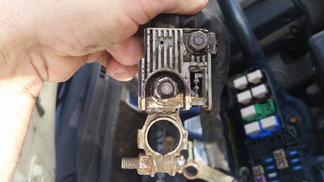

Box on positive battery cable looks like fuse box
2004 SUZUKI XL7
18,000 MILES • V6 • 2WD • AUTOMATIC
AMANDASLIFE3
Was trying to change batteries out. another person hooked cables up to opposite post positive to negative post and negative cable to positive post sparks fired off. when I corrected problem I could not get any power at all.

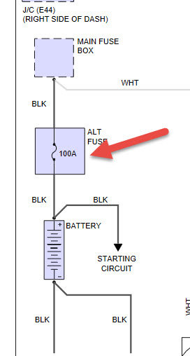

check fuse in picture and all other ones under hood as you may have blown a few of them.
