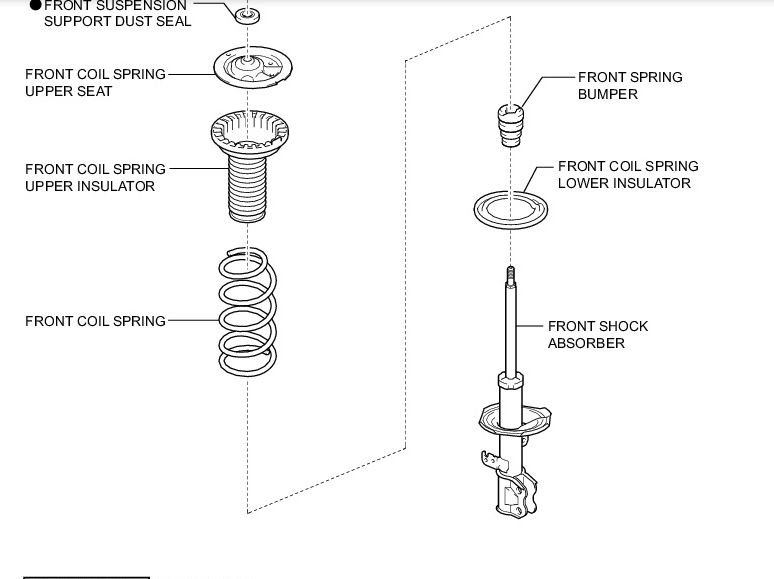

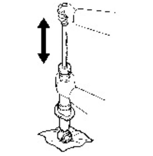

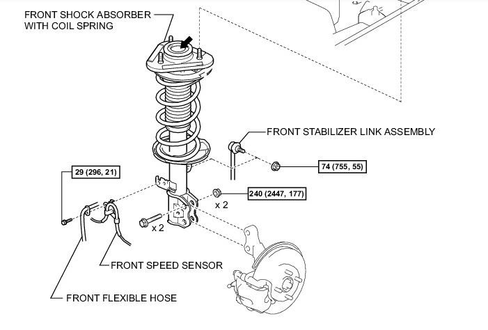

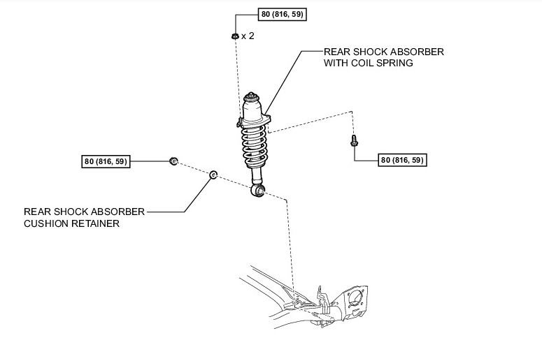

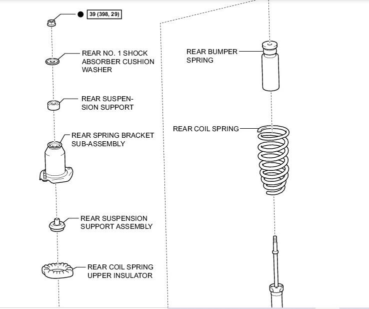

I posted the information below and attached some pictures for you.
REAR SUSPENSION: REAR SHOCK ABSORBER: INSPECTION; 2010 MY Corolla [01/2009 - ]
INSPECT REAR SHOCK ABSORBER ASSEMBLY
Compress and extend the shock absorber rod, and check that there is no abnormal resistance or unusual sound during operation.
If there is any abnormality, replace the shock absorber with a new one.

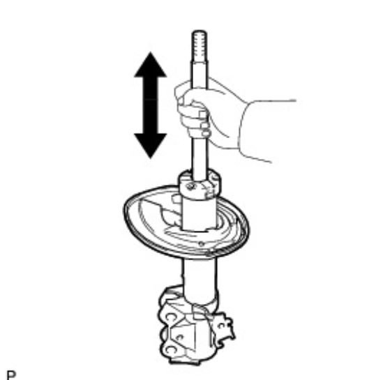

FRONT SUSPENSION: FRONT SHOCK ABSORBER: INSPECTION; 2010 MY Corolla [01/2009 - ]
INSPECT FRONT SHOCK ABSORBER
Compress and extend the shock absorber rod 4 times or more .
Standard:
The operational sound and resistance are normal.
HINT:
If there is any abnormality, replace the front shock absorber with a new one.
