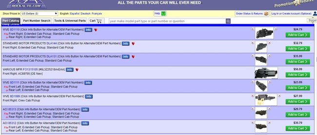

I bought the door lock actuators it said was for my truck. When I opened my door up I found a different door lock actuator. Can I still use the ones I bought?
Nov 13, 2019 at 8:05 AM
Good evening,
What brand and number did you get and which doors need them to be replaced?
I will check on the actuators for you.
Nov 13, 2019 at 8:13 AM

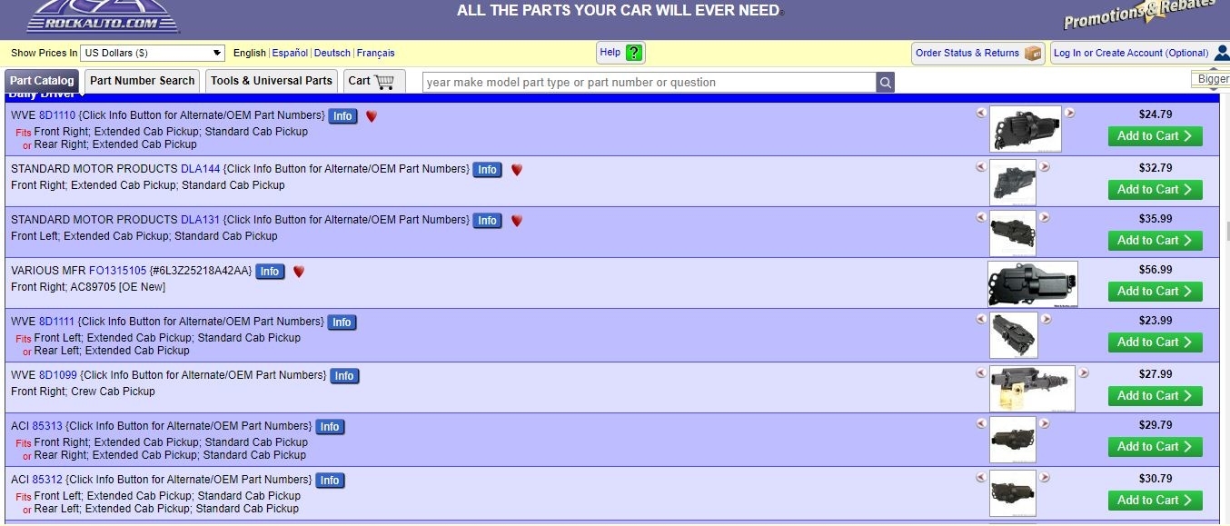

I found these on rock auto for you. They have part numbers for each door and also numbers from Ford as well. Compare it to the ones you have.
I would not want to use something that is not an exact fit for your truck.

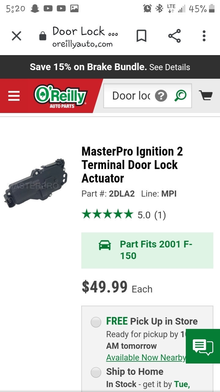

I bought these because it was what was called for my truck when I called ford and talked to them

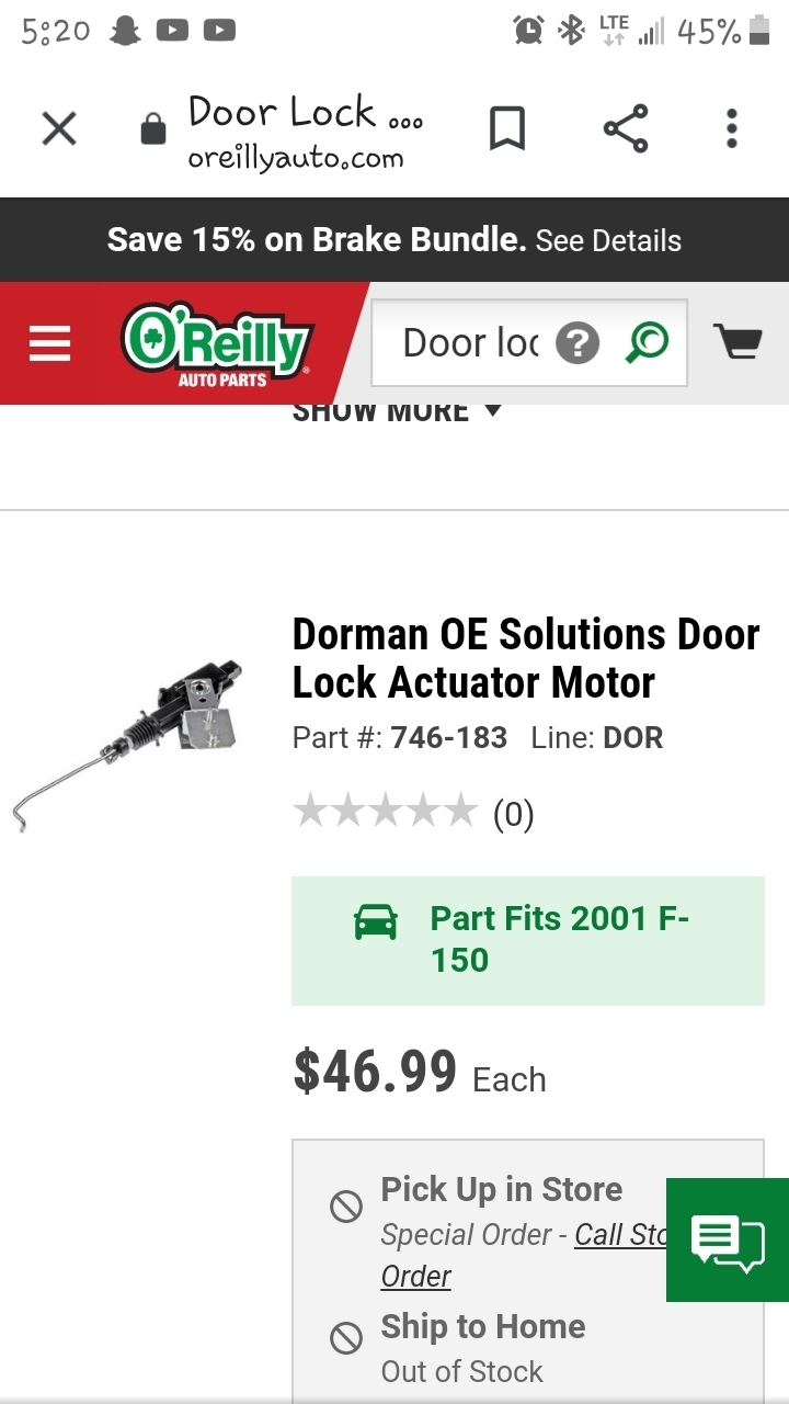

JOHN4030
This is what I found in my door of my truck.
Nov 13, 2019 at 10:00 AM
Got it.
They used both of those actuators.
The Dormans are the correct ones. I would return the Ford units and get the Dormans. You need to use the same ones that are in the door.
