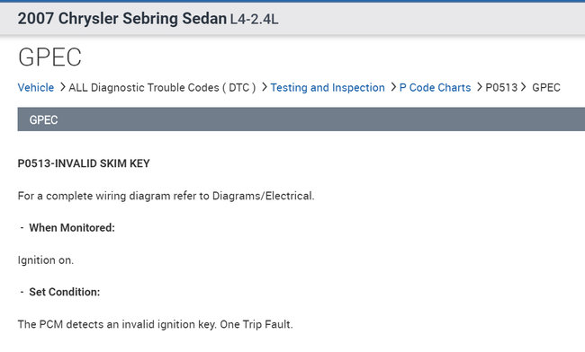

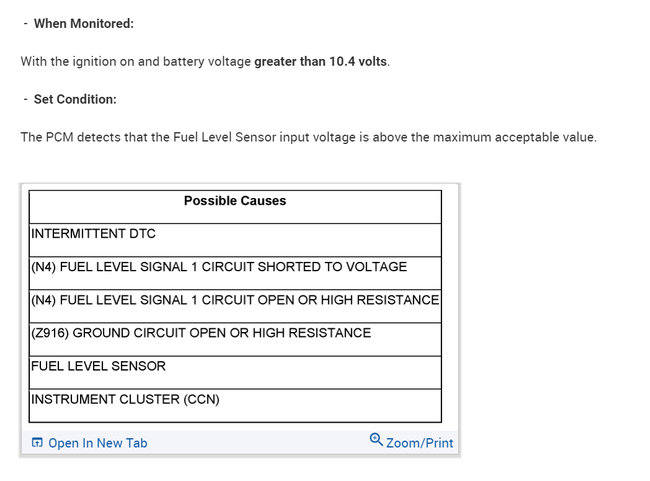

Bought a used car would like opinions on the overall issue, codes P0198, P0513 P0463, P0196, C2202, U140e
2007 CHRYSLER SEBRING
180,000 MILES • AUTOMATIC
GENALEIGH
I got the car only days ago. Today i had a code reader hooked to it and it is showing multiple codes. All of which I have never personally dealt with. Also some of the codes from what I have researched could possibly be from the same issue.
P0198 P0513 P0463 P0196 the more unusual codes- U140e C2202.

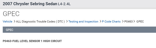

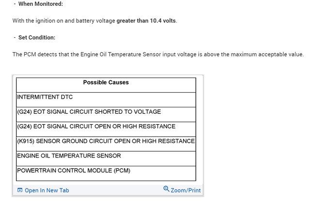

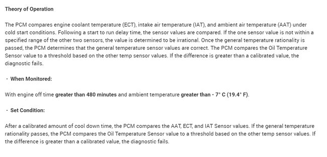

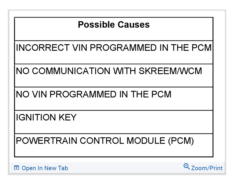

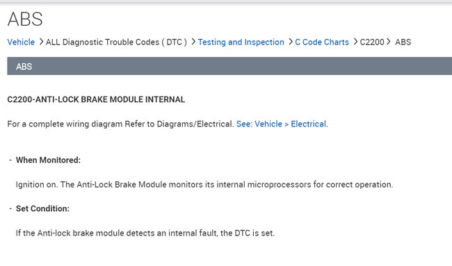

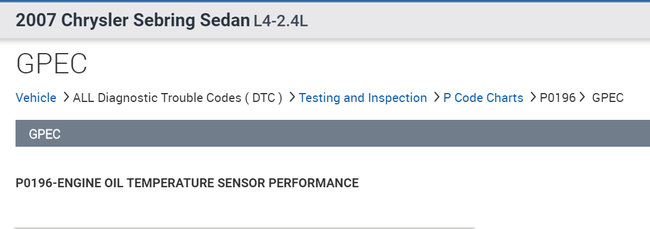

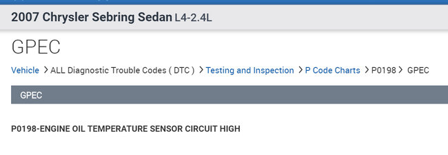

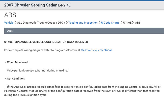

I have included the descriptions and probable causes for the Direct Trouble Codes (DTC) you sent in the diagrams below. The only one that would really concern me is P0513. How well do you know the person you bought the car from? This DTC is for an unprogrammed key. I am not saying the car is stolen, but we just don't want to get in any trouble. Having said that, we also have step by step instructions for tracking down and fixing all these DTC's, and can give them to you on request. Let us know.
Thanks,
Alex
