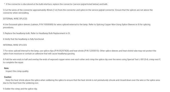

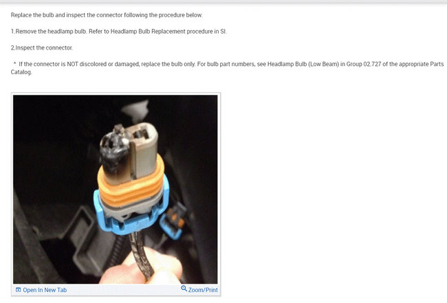

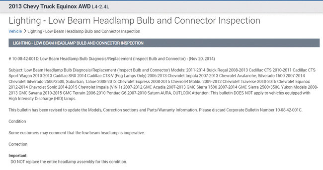

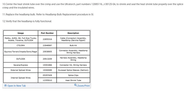

There is a technical service bulletin (TSB) related to this issue. According to the TSB, there is a likely hood that the connector at the bulb has failed (melted). I attached the TSB below for you to review. Inspect how it indicates and let me know if the connector is the issue.
The TSB explains how the problem is repaired.
