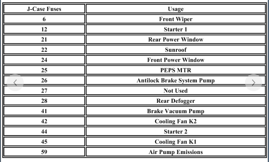

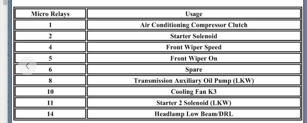

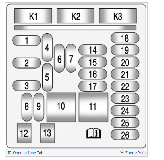

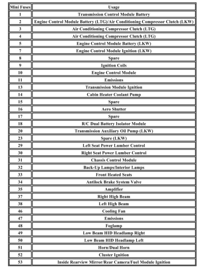

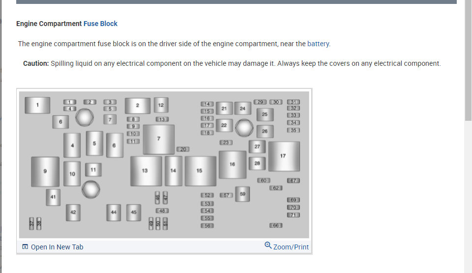

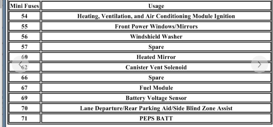

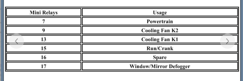

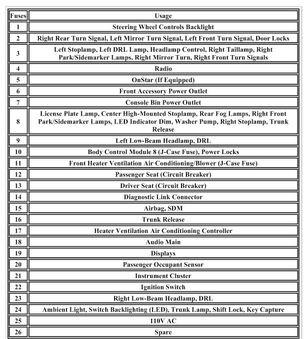

Both bulbs are good by checking continuity. Not sure why there is power although very slight on both terminals of both sockets. Can you help me find and check the fuses?
Dec 4, 2017 at 9:16 AM
Here is a guide that will help with testing and replacing fuses:
Please use the attachments below for more info on your fuses. Please let us know if you have other questions and we can go from there.
