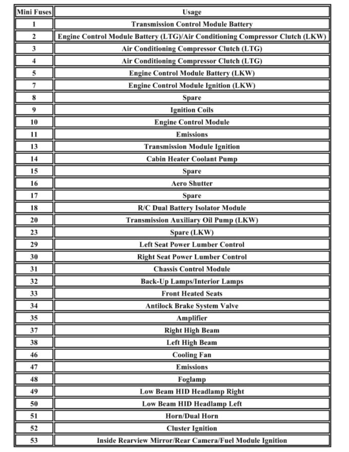

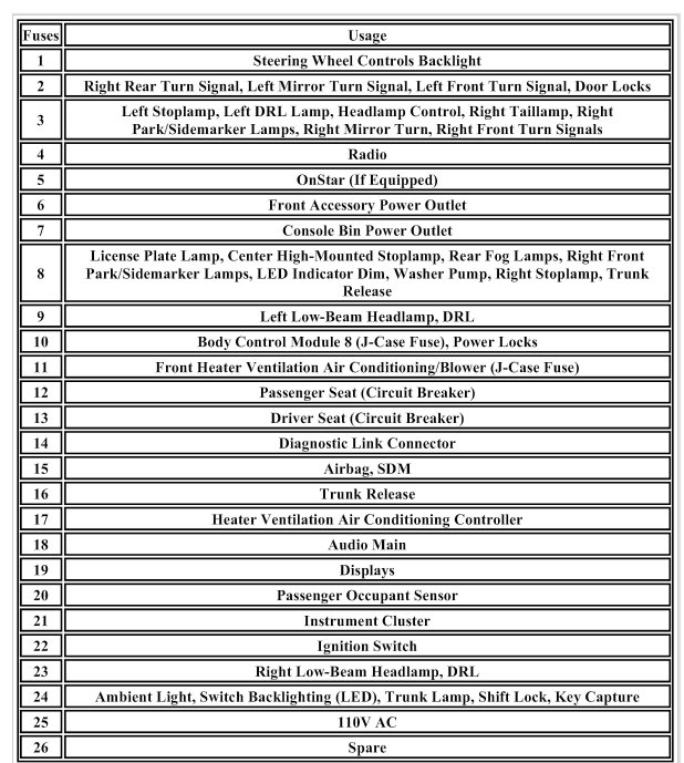

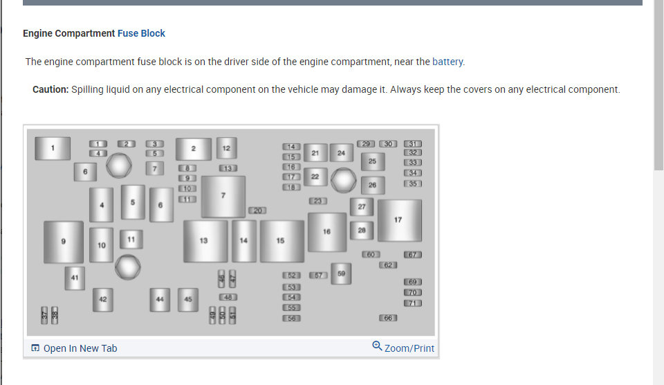

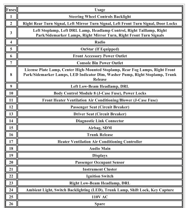

Both bulbs are good what the fuses go too?
2015 CHEVROLET MALIBU
22,000 MILES • 2.5L • 4 CYL • 2WD • AUTOMATIC
FRANK1874
Both bulbs are good by checking continuity. Not sure why there is power although very slight on both terminals of both sockets. Can you help me find and check the fuses?
Dec 4, 2017 at 9:16 AM

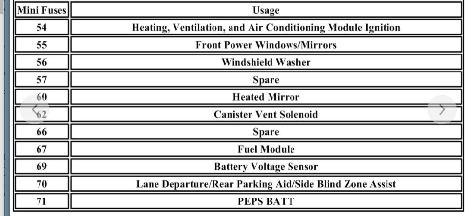

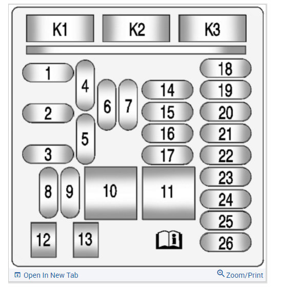

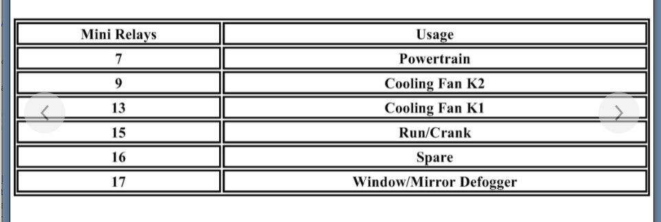

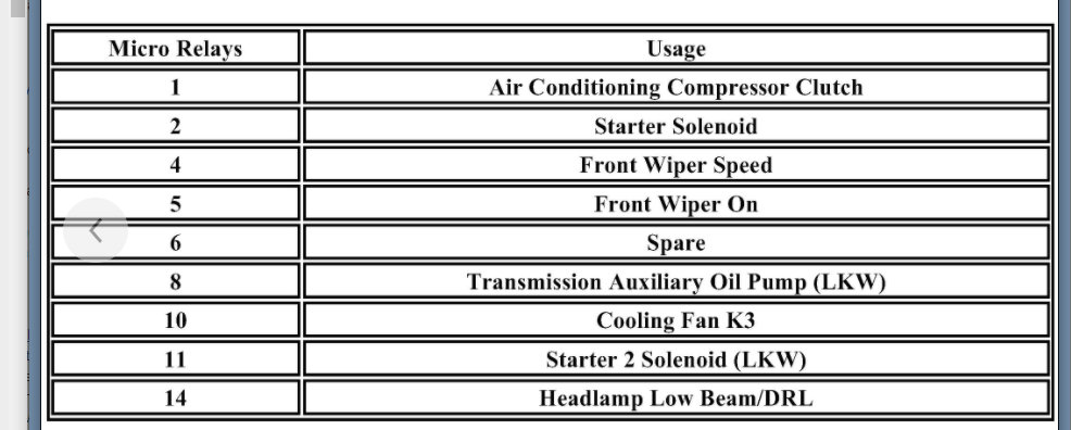

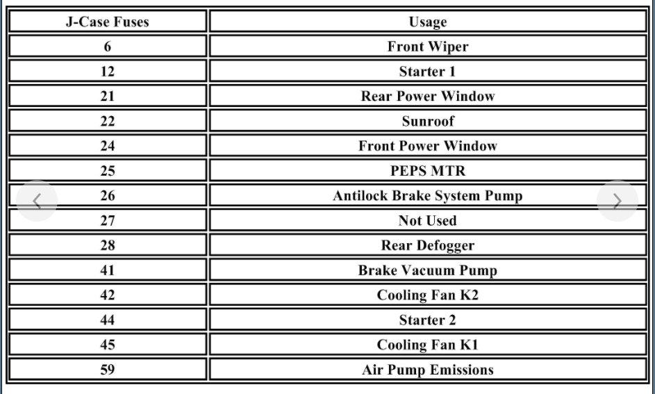

Here is a guide that will help with testing and replacing fuses:
Please use the attachments below for more info on your fuses. Please let us know if you have other questions and we can go from there.
