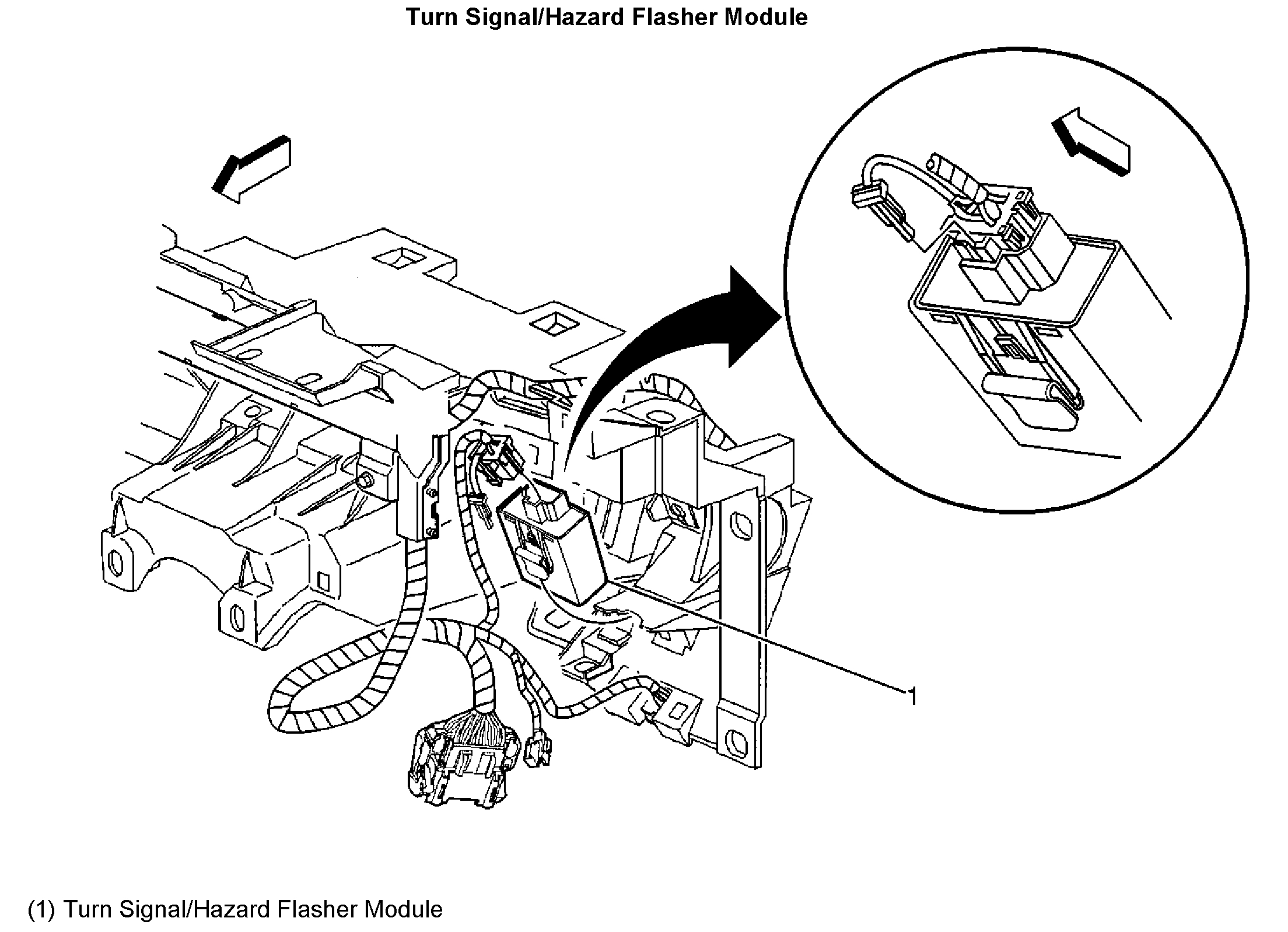

Both left right and flashers do not work
2003 BUICK LESABRE
1,300,000 MILES
JUST A GIL
My dad, retired 78 year old old mechanic can’t remember the name of the main thing that makes flashers work. he thinks it may be called the flasher module, he needs to order the part so he can install it. he knows it goes under the dash he tells me “ your just a girl” and “ have no idea how these things work “ Seriously I am not mechanically inclined. Help!

I have met women mechanics that are amazing at working on vehicles, so don't be hard on yourself.
Now, I believe he is referring to the flasher module. It is located under the dash. I attached a picture of it.
Let me know if you need help or if you have other questions.
