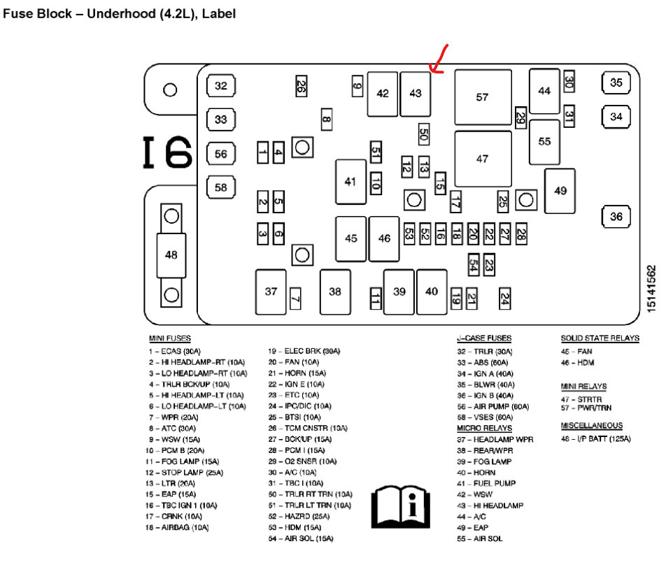

Hi, my vehicle listed above EXT model, both high beam lights are not working. I checked the bulbs, fuse and relay and are appeared to be working.
What do you suggest I try next?
Thanks,
John
Nov 15, 2023 at 8:03 PM
  • 55,746 POSTS

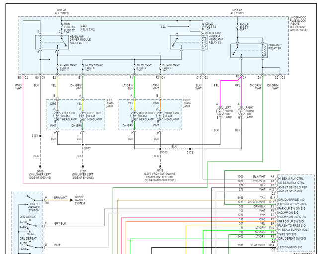

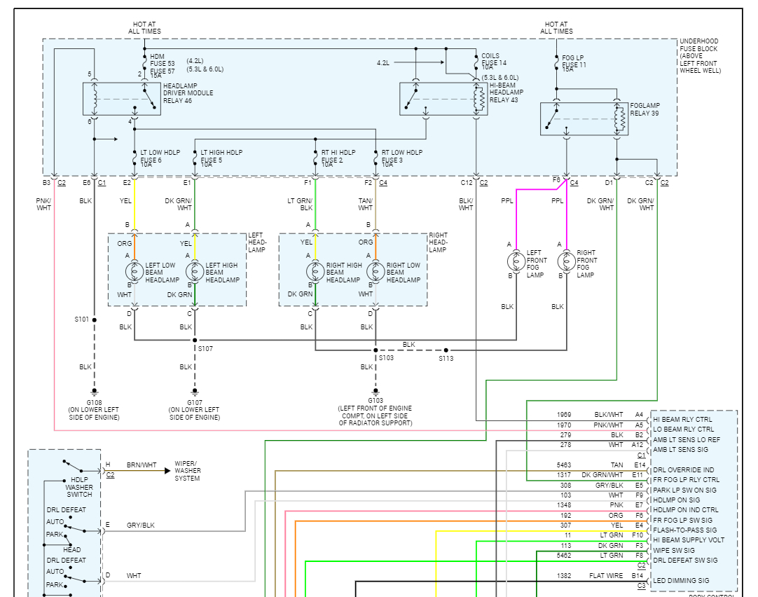

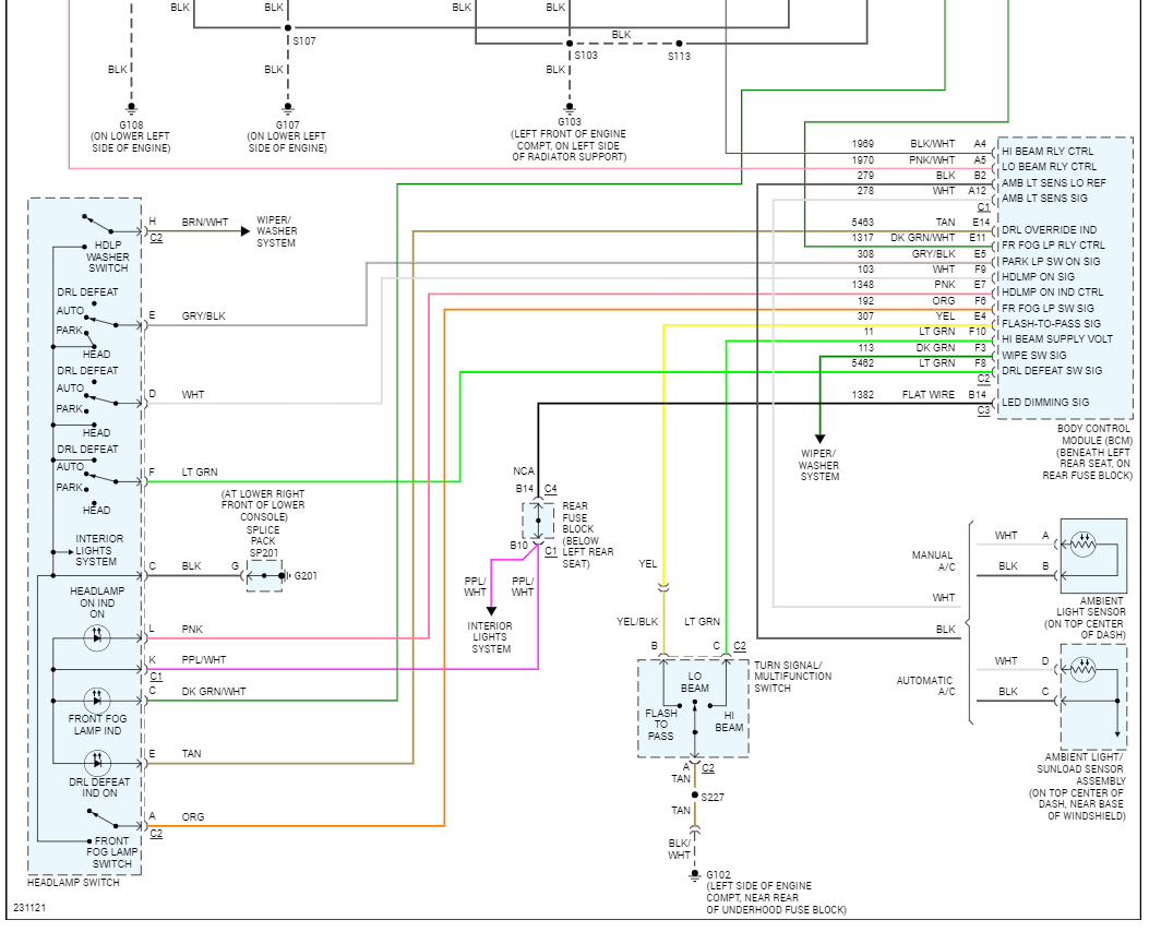

There is a headlamp relay #43 we need to look at because it sounds like it is not working. Here is the location of the relay and I have included the headlight high beam and low beam wiring diagrams so you can see how the system works as well. Check out the images (below). Let us know how it goes.
Nov 16, 2023 at 3:03 AM
JJV_119
Thanks for the help the relay was the problem.
