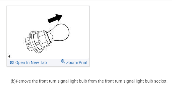

Both Front turn signals do not operate, and the flasher is on hyper blink mode?
2014 TOYOTA TUNDRA
10,500,000 MILES • V6 • 4WD • AUTOMATIC
JOHNCHARCHO
The rear turn signals work.
May 20, 2023 at 6:42 AM
  • 110,240 POSTS

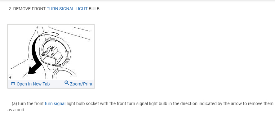

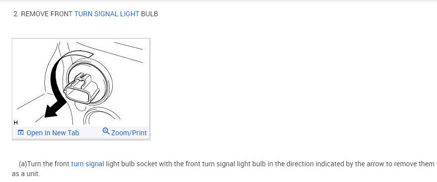

Have you checked the bulbs? If they are bad, this will happen. I believe these bulbs are dual-element bulbs. Basically, it's two lights in one. If they both failed at the same time, let me know that as well because likely, that wouldn't happen.
Remove the bulbs and inspect them. Let me know what you find. I attached the directions below for replacement.
