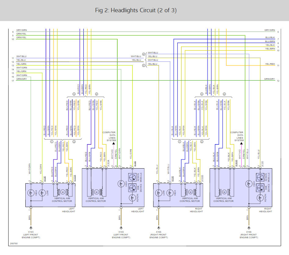

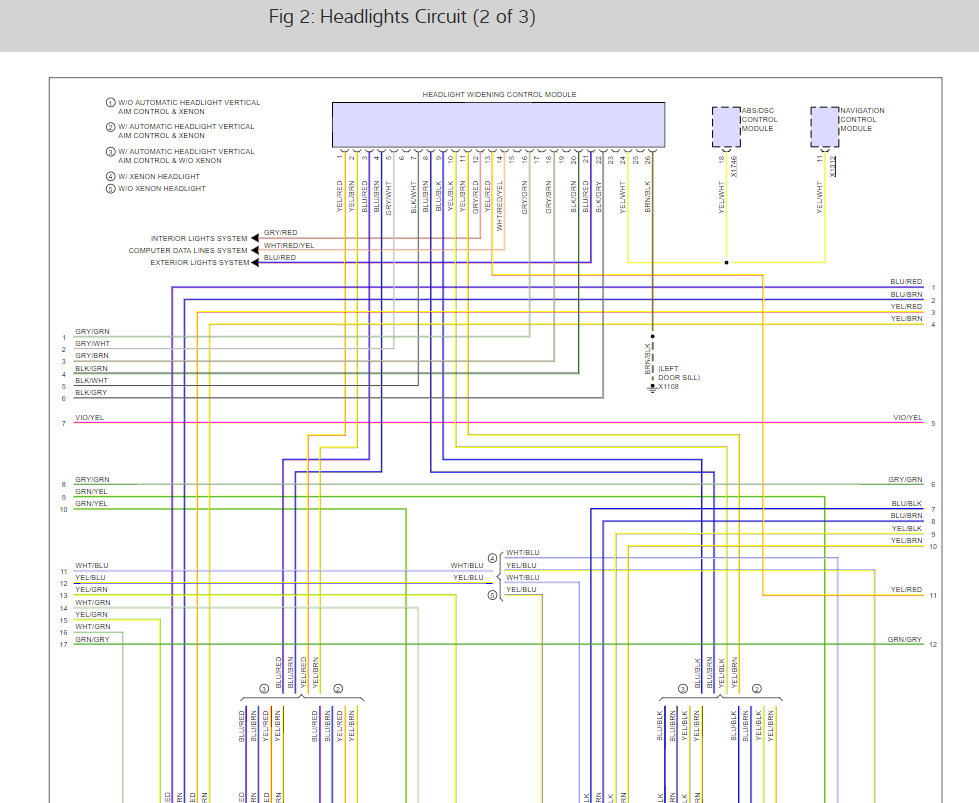

Pretty much sums it up. Both went out weeks ago, they have always worked but, did have Angel eyes installed recently.
Nov 7, 2017 at 6:57 AM
  • 55,112 POSTS

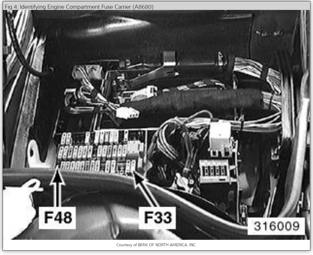

The first thing that comes to mind is the fuse. The fog lights are controlled by the lighting control module which is run by several fuses.
Here are a couple guide to help you see what is up:
and
Fuses by Fuse Number

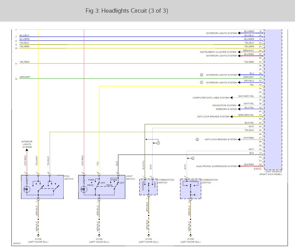

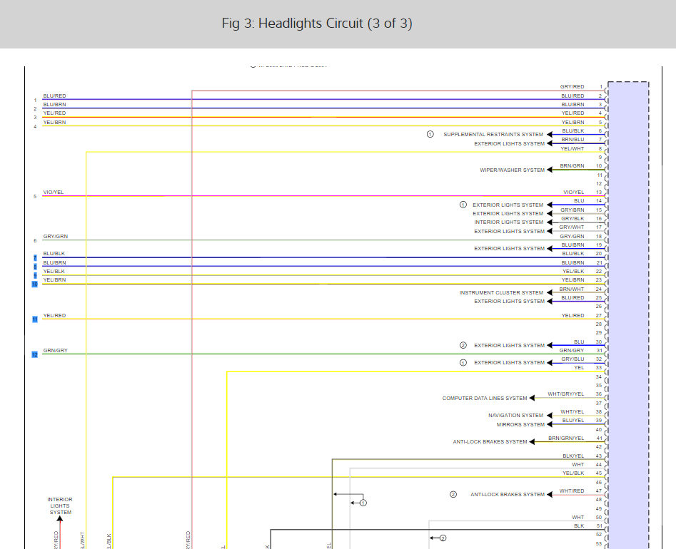

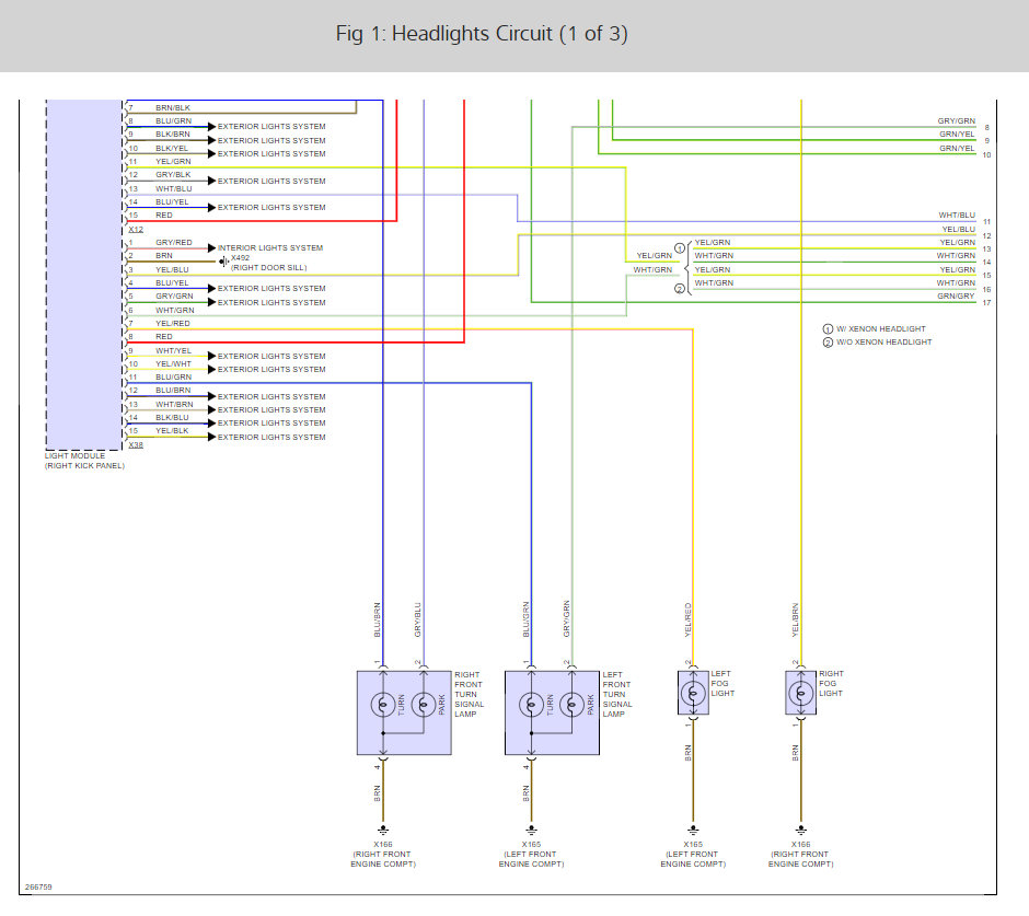

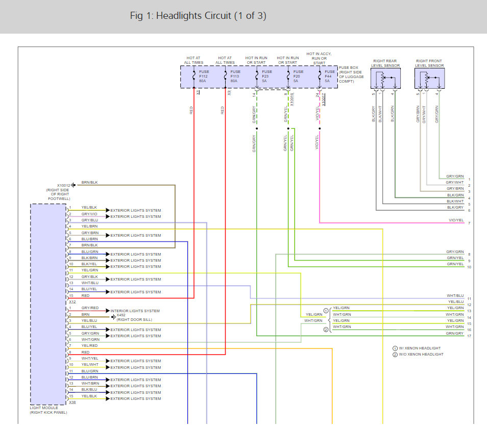

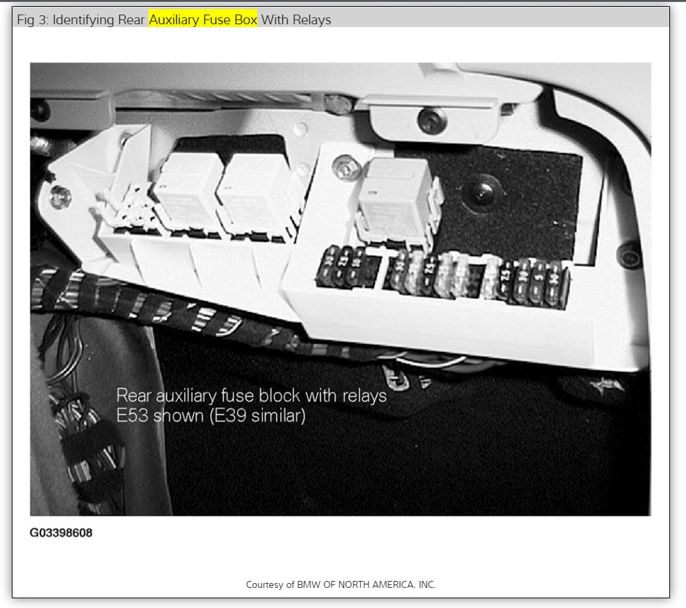

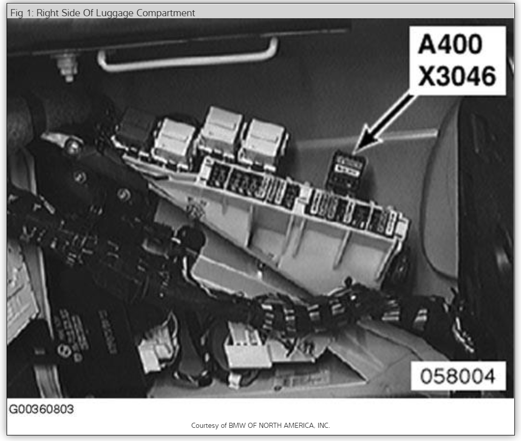

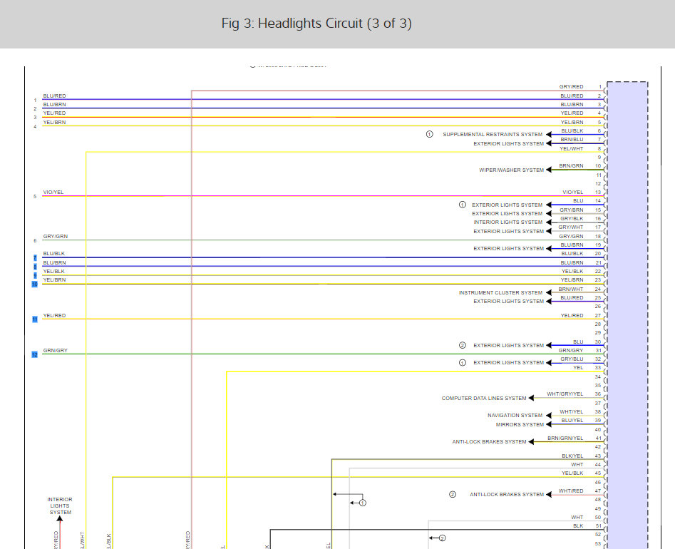

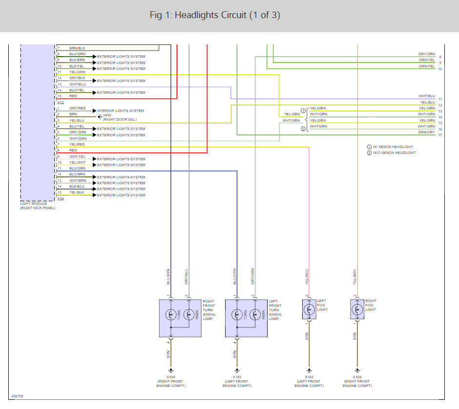

See where the system loose power check out the fog light wiring diagrams and fuse panel identification (below).

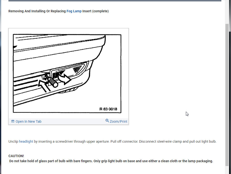

how do you replace the drivers side fog light?
Feb 1, 2021 at 2:18 AM (Merged)
I am attaching the process for replacing the fog light from the manual.
Also, here is a video for a Ford that will give you some more info if needed or for others that visit this page:
https://www.youtube.com/watch?v=rA3IIgQyx0g
Please see the process below and let us know if you have questions. Thanks
