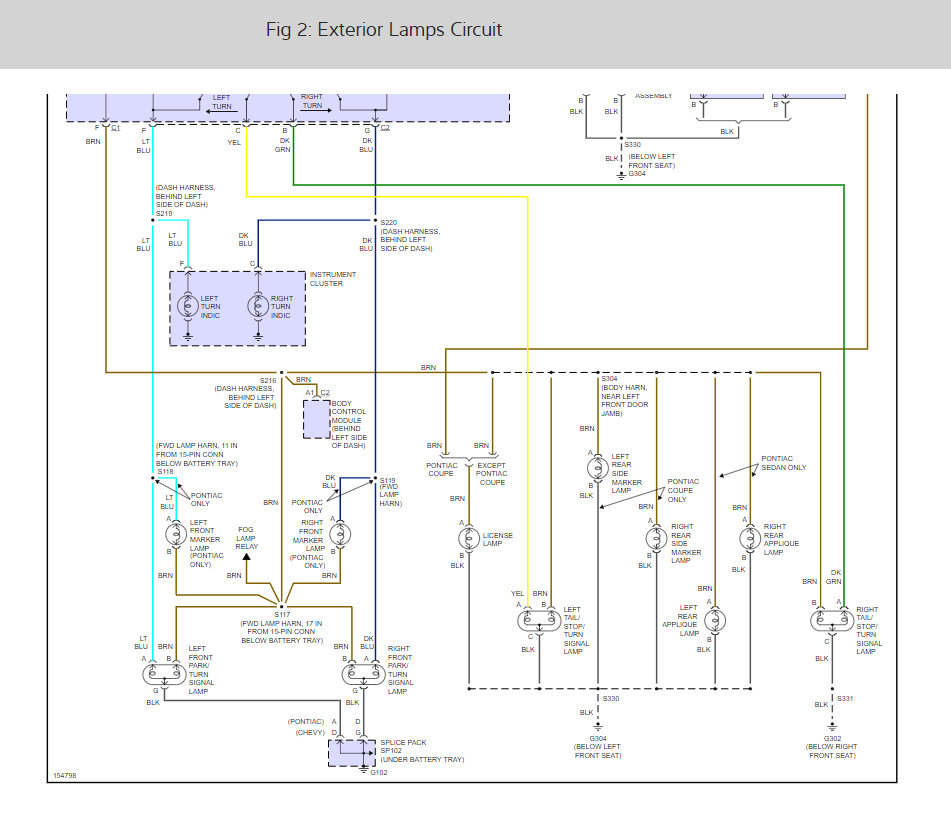

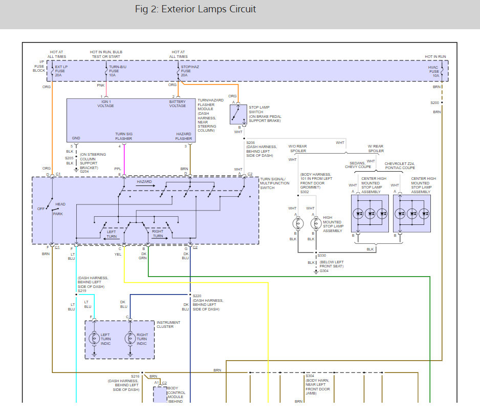

First, I double check those bulbs to make sure that they are in fact good. Buy a couple of new bulbs and try them. Sometimes bad bulbs will look perfectly fine. If that does not work use a test light to make sure that there is power to the brake light sockets with someone pushing on the brake pedal. Obviously the brake switch works because the third brake light lights up so it looks like the turn signal switch is no good but to be sure here is a guide and the brake light wiring diagrams so we can confirm the failure.
Check out the diagrams (Below). Please let us know what you find. We are interested to see what it is.

Thanks for this guide, I found out the multi function switch was bad I had to get a new one cost me $121.00 all fixed!
