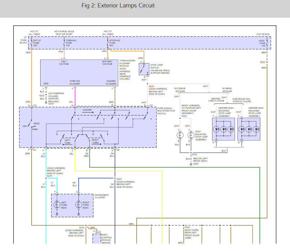

Hi I have recently found out that both my rear brake lights are not working. The central LED brake light in the back windscreen works when the brake pedal is pressed down though.
I have checked bulbs and they are fine. I have checked fuse and that is fine. My next part was the switch but was told that it may be the wiring or circuits for the brake lights.
Can anyone please give me any idea as to where I start looking for the fault? Many thanks

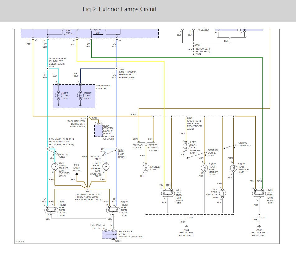

First, I double check those bulbs to make sure that they are in fact good. Buy a couple of new bulbs and try them. Sometimes bad bulbs will look perfectly fine. If that does not work use a test light to make sure that there is power to the brake light sockets with someone pushing on the brake pedal. Obviously the brake switch works because the third brake light lights up so it looks like the turn signal switch is no good but to be sure here is a guide and the brake light wiring diagrams so we can confirm the failure.
Check out the diagrams (Below). Please let us know what you find. We are interested to see what it is.

Thanks for this guide, I found out the multi function switch was bad I had to get a new one cost me $121.00 all fixed!

Do you have power at the switch and power through the switch with the pedal depressed? Check with a test light.

If battery voltage is available st the brake switch terminal, use a fuse wire to bridge the 2 terminals and check if the brake lights comes on. If no, you have a fault with the wiring circuit or brake bulbs.
