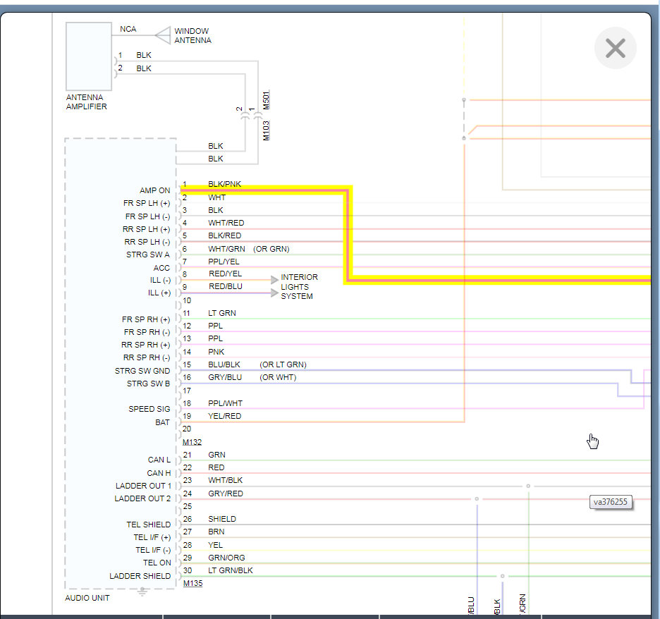

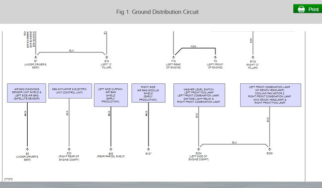

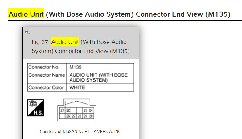

Radio stopped working, wont turn on. CD will occasionally show its playing but no sound. Then randomly two weeks later there is sound. it worked for two days and stopped working again.
Apr 11, 2019 at 11:37 PM
SCGRANTURISMO
  • 4,897 POSTS

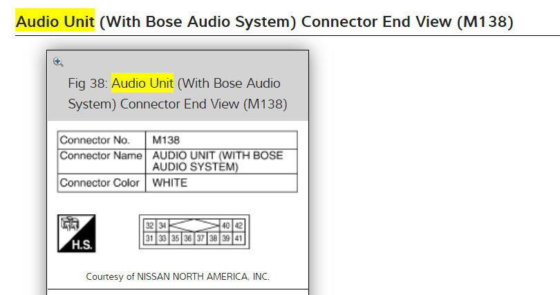

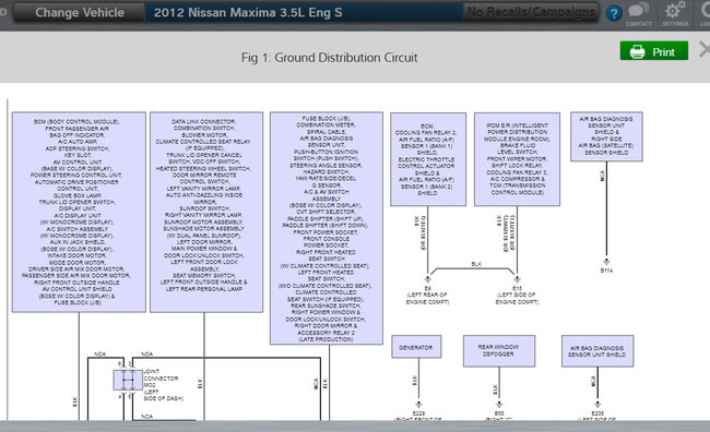

This could be a problem with the ground. The ground for your vehicle's stereo is M57 and it is located behind the right side of the dashboard. Check this ground out and make sure it's dry, clean, free of corrosion, and making good metal to metal contact. I have included ground distribution diagram as well as connector end views for your stereo in the diagrams down below. Please go through these guides and get back to us with what you find out.

My radio comes on and the sound does not. The volume button stays idle and doesn't go up/down. It just sits there. Days later I crank up my car and the radio mysteriously comes on. I turn the car back off and then on again and no more sound.
Jun 2, 2021 at 8:03 AM (Merged)

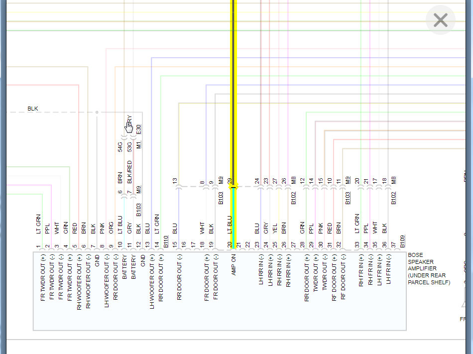

Just to be clear, when you turn the volume knob the scale does not change? It just stays on the same number? If that is the case then the radio is the issue.
If the volume scale goes up and down, but no volume then I suspect the amp is the issue.
The way to confirm this is to check power on the amp signal from the radio to the amp. I attached the wiring diagram for this. Let's check power and go from there but it does sounds like the radio is the issue.

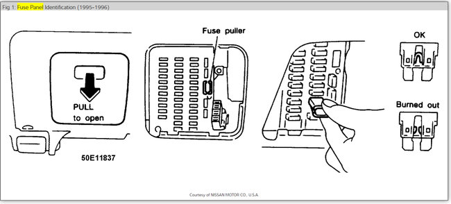

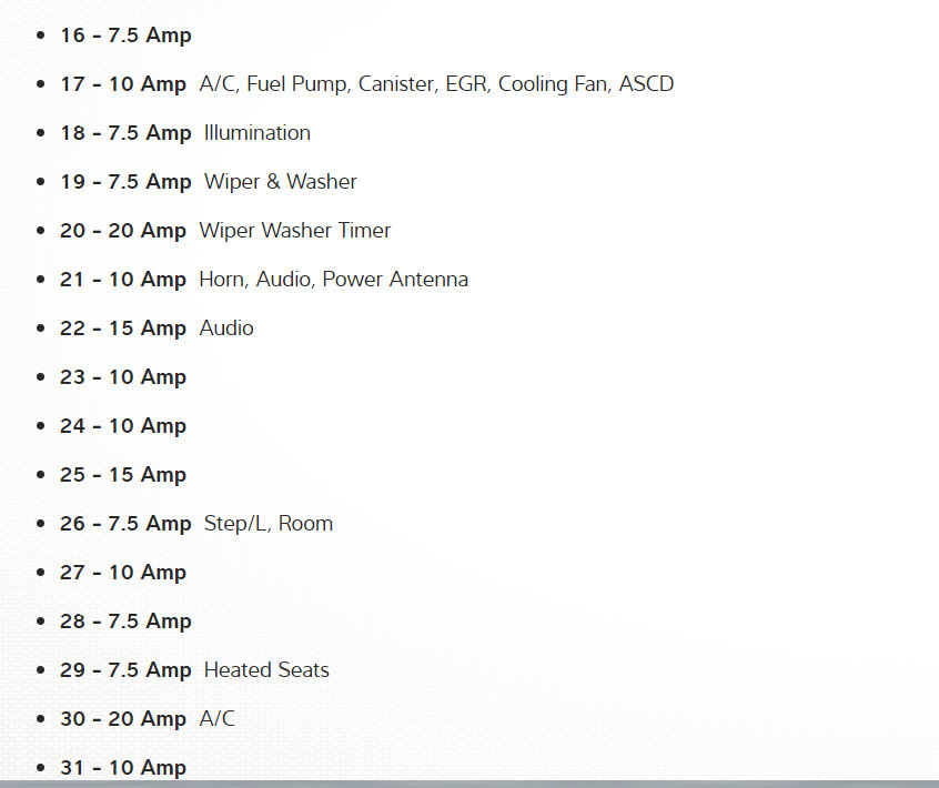

After trying to replace the power antenna kit im my car (and failing) the stereo and clock in the car no longer turn on when the car is started. I tried multiple different wiring connections when trying to install the power antenna. I thought that it might be a blown fuse but i checked all the fuses that i thought it might be and none were blown. Currently there is no power antenna in the car and the stereo and clock still do not turn on.
Jun 2, 2021 at 8:08 AM (Merged)
CARADIODOC
  • 34,414 POSTS
Hi GregAl/ Welcome to the forum. It sounds like a fuse is out here is a guide to help you test them for power and the fuse locations below.
GREGAL
I dont know if this matters but the current head unit for the stereo is an alpine that i installed a couple of years back. Another thing of interest that i just noticed today is that my remote control keys ( that unlock or lock the car / trunk release) no longer work. Maybe that gives another hint to where the problem is.
CARADIODOC
  • 34,414 POSTS

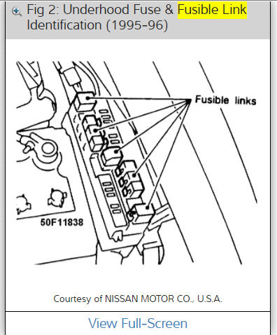

Yup. I think you're going to find a blown fuse for the radio's memory circuit. It will be tied into a circuit that is always live such as your remote keyless entry system. Dome lights and horn are other common circuits. Look for two fuse boxes, one under the hood and one inside the car.

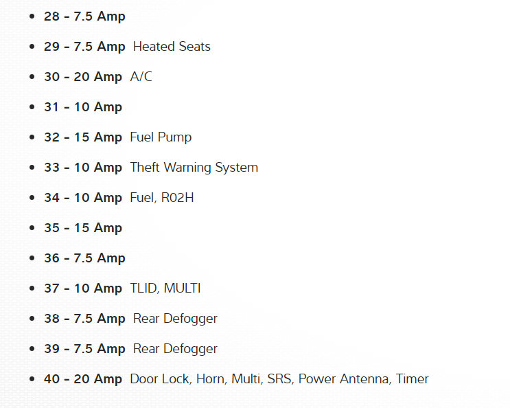

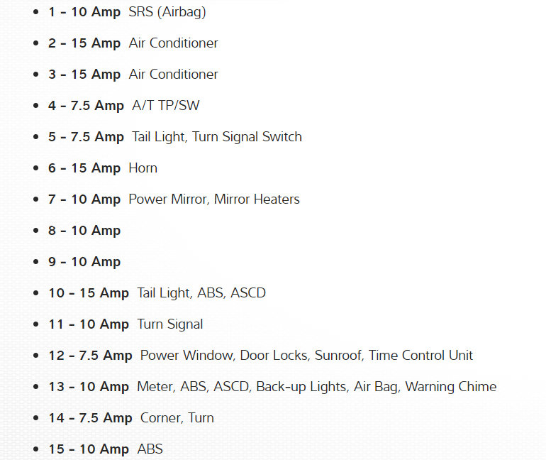

GREGAL
Thank you I finally found the fuse. It was the top right fuse (7.5 amps) in the fuse box on the inside of the car by the drivers seat.

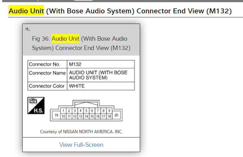

Did the new fuse blow? If all the fuses are good in the car and under the hood, pull the radio out and check for voltage on two pins in the connector. One should have 12 volts all the time and one should have 12 volts only when the ignition switch is turned on.
JOZIAHBOWEN
ok i just did thatand still no sound all you hear is the antennaa motor humming this problem is driving me crazy
CARADIODOC
  • 34,414 POSTS
Then there's a problem in the radio.
