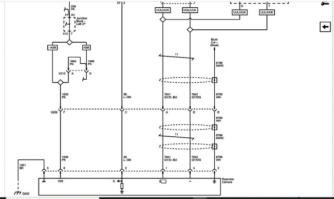

there are 4 connections to the radio.
(2) go to wiring harness, (1) antenna, (1) micro USB? I want to install an aftermarket radio but I don't know what the micro-USB is for? Also when I took out the Bose, the backup park assist stopped working.

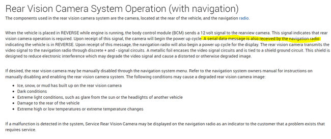

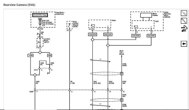

When you removed the radio, you opened the park assist system was opened. The beeping is powered via the radio. If you look at pic 1, I highlighted where it is indicated in the operation of the unit. Also, pics 2 and 3 are the schematic. You can see where the radio is tied in.
When you say it has a micro USB, that is usually just another input connection for the radio. I can tell you that USBs are starting to be used for other purposes. Some manufacturers are using them to connect the different systems. Since you only have two wires, the antenna, and the USB, I suspect the following. The two wires are likely a power supply and a ground. The antenna wire is just that. The USB connection is for the speakers. If that is the case, you will likely need to get an adapter to wire into your truck.
