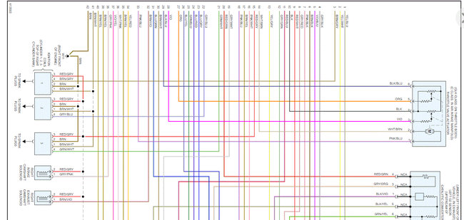

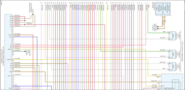

Hi everybody.
Please i need your help to find Bosch med17.7.2 PCM, ECU connector pinout.
Thanks for all.
Sep 17, 2020 at 9:59 PM

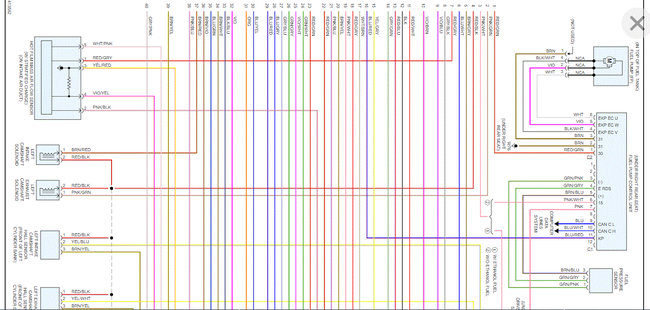

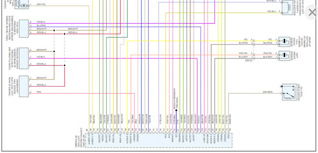

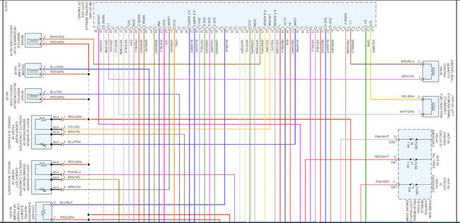

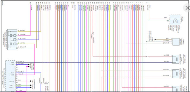

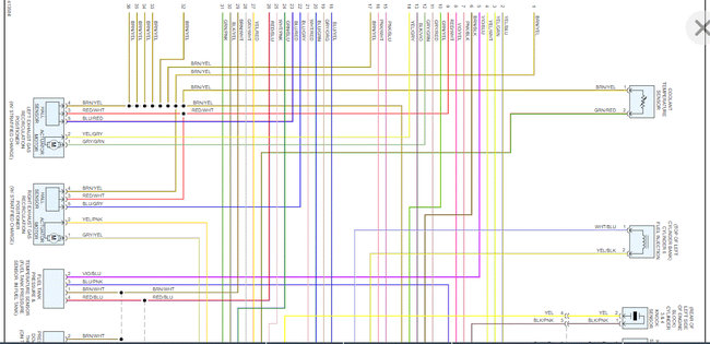

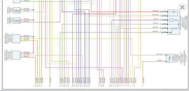

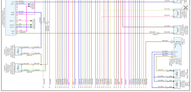

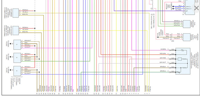

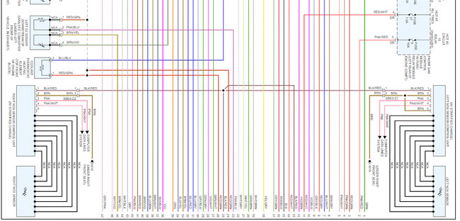

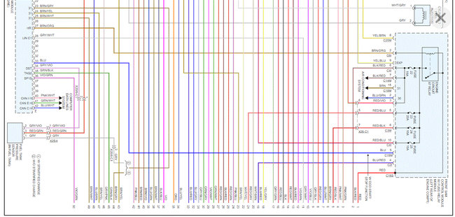

Good morning,
I attached the diagrams for the car for you to view below.
Sep 17, 2020 at 10:20 PM

I mean the pictures that you sent to me where you got it?
Sep 18, 2020 at 1:25 AM
Alldata. That is our source of the information we supply to our customers.
Sep 18, 2020 at 1:29 AM
B_ALZUABI77
  • 25 POSTS
I have it but i didn't find the wiring.
Can you please tell me step by step where you find it and how can i find it? i have Alldata software.
Sep 18, 2020 at 1:39 AM
Enter the information of the car and then when the screens come up, go to the left for diagrams. Pick electrical diagrams and scroll down to power train diagrams and click on it. It should open all 6 pages that I sent you.

I have Mitchell too but not there .
So the pictures you sent its for MED17.7.2??
I will use it to connect the car simulator to the ECU.
