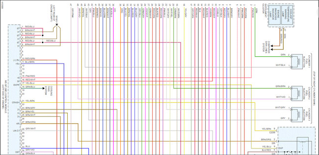

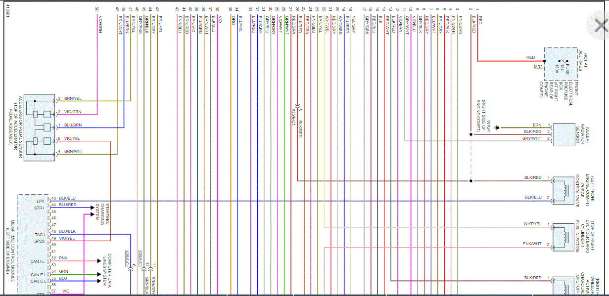

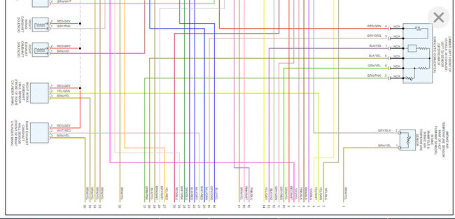

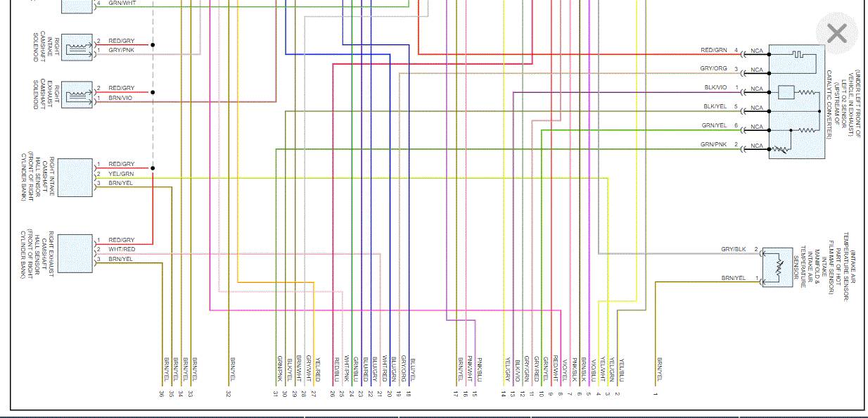

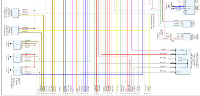

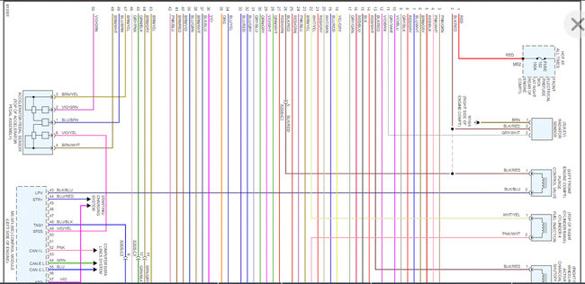

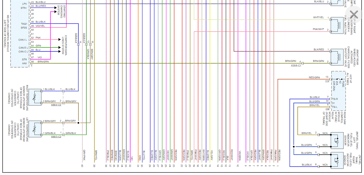

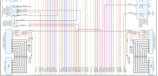

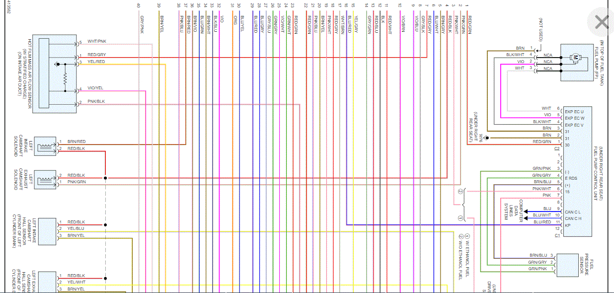

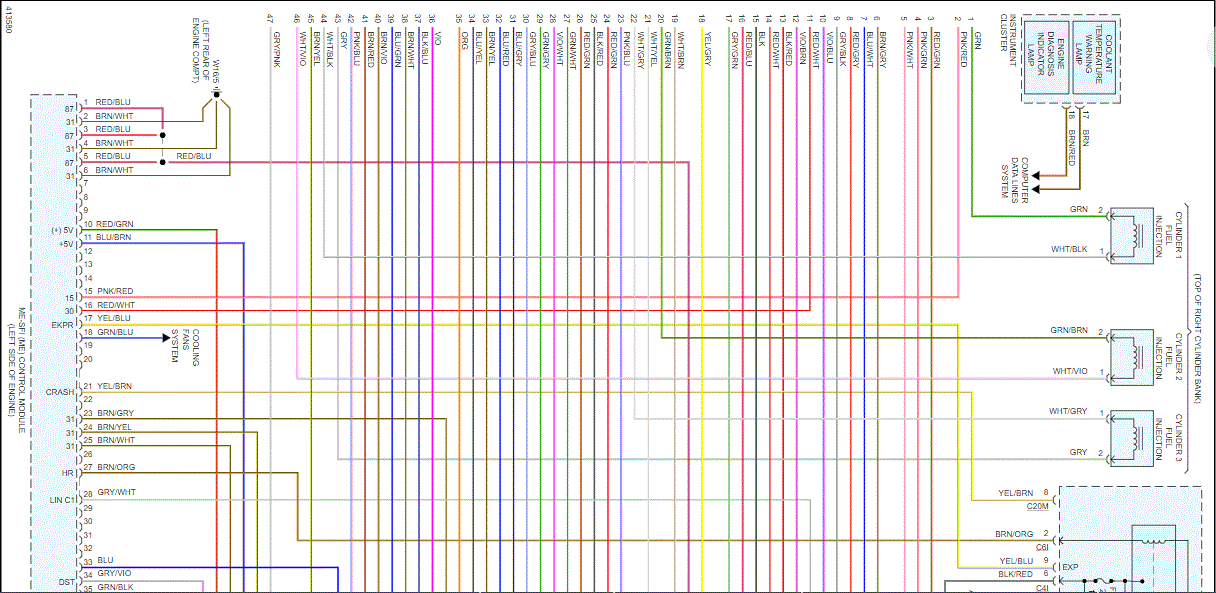

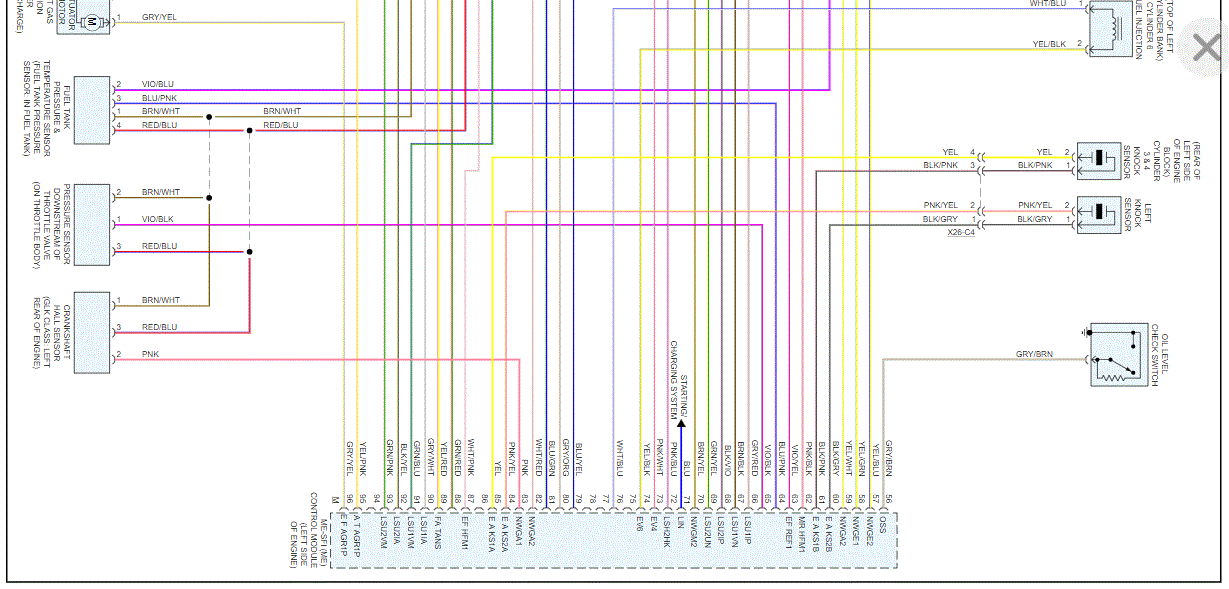

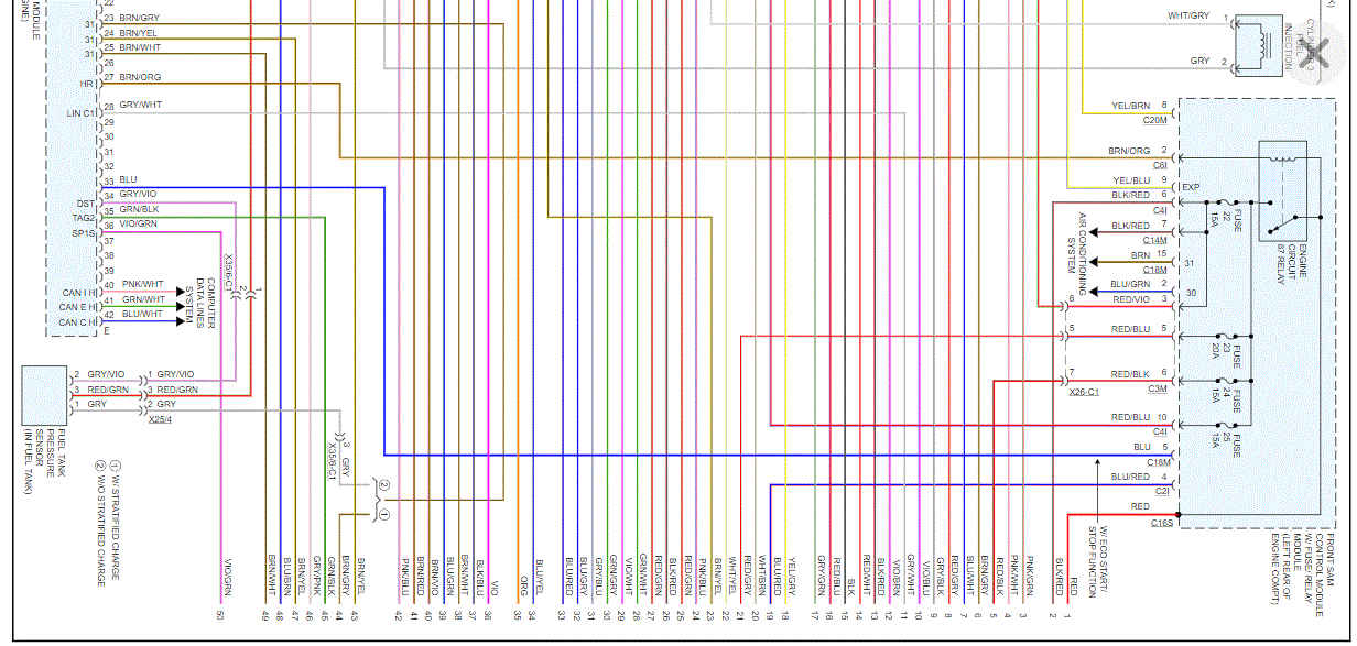

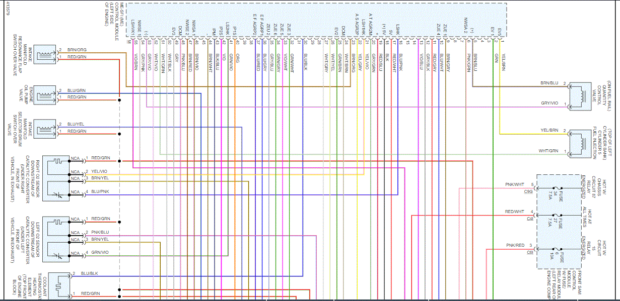

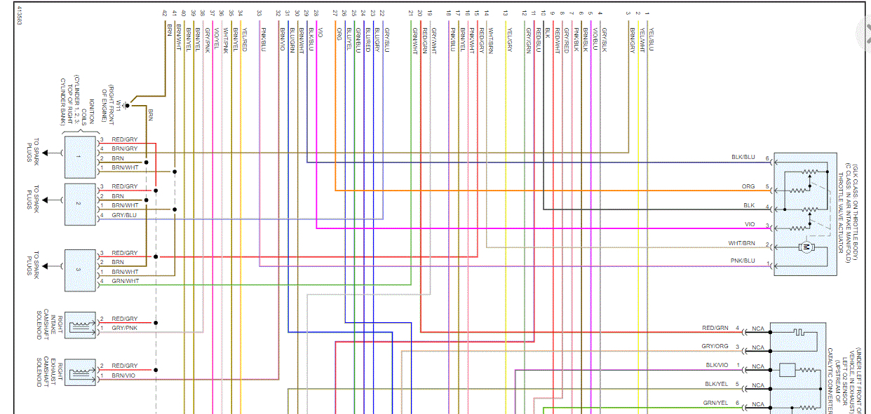

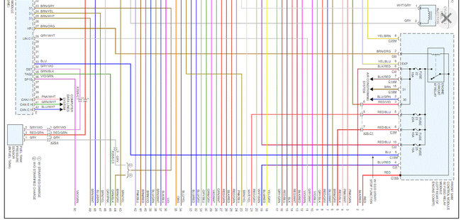

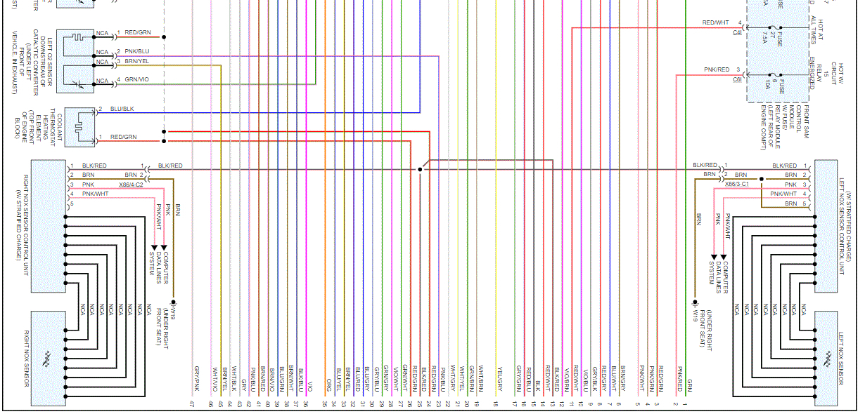

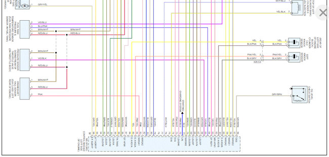

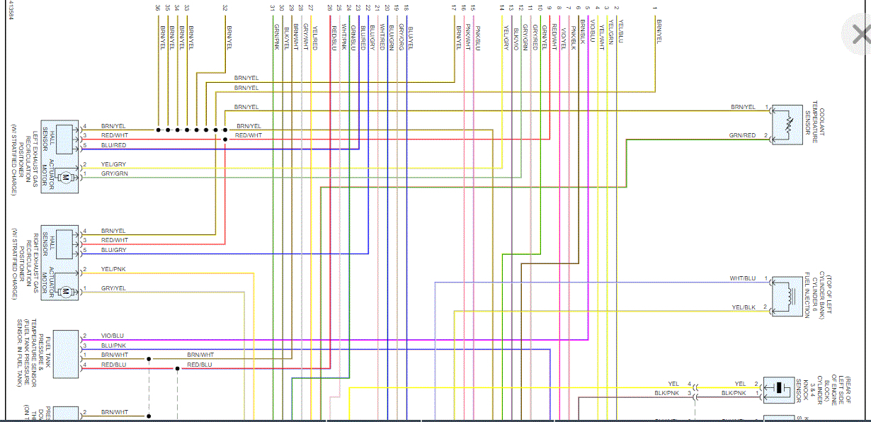

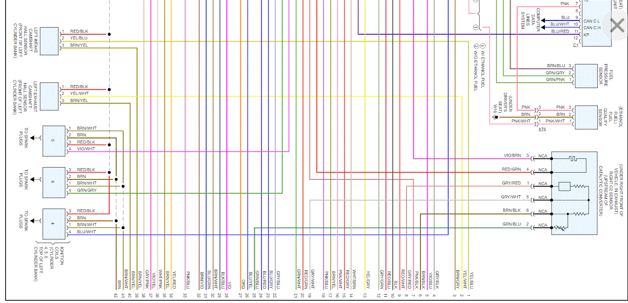

Please i need your help to find Bosch med17.7.2 PCM, ECU connector pinout.
Thanks for all.
Sep 17, 2020 at 9:59 PM
Good morning,

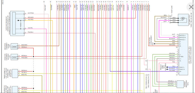

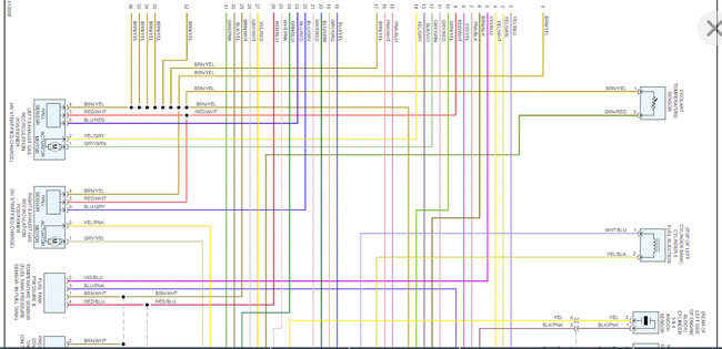

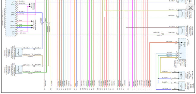

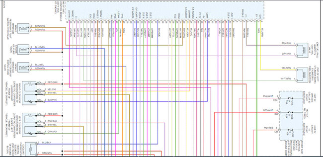

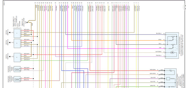

I attached the diagrams for the car for you to view below.
Sep 17, 2020 at 10:20 PM
B_ALZUABI77
  • 25 POSTS
Where can i find it? Which software?
It's really useful pictures.
Thanks
Sep 18, 2020 at 12:48 AM
That is an engineering question which I cannot help with.
You would need to check with someone from Mercedes Benz technical support for that information.
Sep 18, 2020 at 12:52 AM
B_ALZUABI77
  • 25 POSTS
I mean the pictures that you sent to me where you got it?
Sep 18, 2020 at 1:25 AM
Alldata. That is our source of the information we supply to our customers.
Sep 18, 2020 at 1:29 AM
B_ALZUABI77
  • 25 POSTS
I have it but i didn't find the wiring.
Can you please tell me step by step where you find it and how can i find it? i have Alldata software.
Sep 18, 2020 at 1:39 AM
Enter the information of the car and then when the screens come up, go to the left for diagrams. Pick electrical diagrams and scroll down to power train diagrams and click on it. It should open all 6 pages that I sent you.
Sep 18, 2020 at 1:46 AM
B_ALZUABI77
  • 25 POSTS
I have v10.52.
Is it same ??
I had it from aliexpress website.
Sep 18, 2020 at 2:30 AM
It should be as they all get this information from the same places. Mitchel has the same diagrams.
Sep 18, 2020 at 2:41 AM
B_ALZUABI77
  • 25 POSTS
I have Mitchell too but not there .
So the pictures you sent its for MED17.7.2??
I will use it to connect the car simulator to the ECU.
Thanks
Sep 18, 2020 at 3:32 AM
You are welcome.
Always glad to help.
Sep 18, 2020 at 3:33 AM
