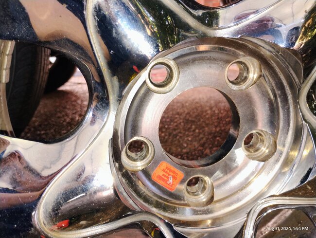

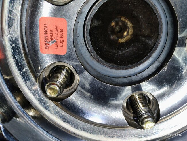

I'm looking to put different wheels on my truck. Currently 15 in and from what I've read 5x 4.5..an bore is 60.1..not sure on width.
I found some wheels from a Nissan Altima around same year that have same lug an 5x4.5 but bore is larger at what looks like ,from internet search 67.1...What parts will I need exactly to help with the fit, and if the holes are a tad larger than OEM also...an what type of nuts?
Any additional info is appreciated

Would I need these things called spacers?
Pic is new rim

The holes where stud goes in look a tad bigger too.
Sep 2, 2024 at 1:00 AM
  • 55,433 POSTS
Yep, this is a common problem when trying to mix and match rims onto different applications. You will probably need to have the center spacers custom machined to make the rims work, I am not sure about the lug nuts, it might be best to go to a tire shop and see what they have.

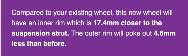

I'm told the offset impacts it too, will that pose an issue? Mine ranges 32-36 and I see these new ones are 45.
Sep 2, 2024 at 5:53 AM
  • 55,433 POSTS
Yep, that can cause the car to get worse mileage, and the car will not steer or handle as well. You may even have clearance issue to the fender well.

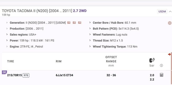

I'm getting 5 x114.3 ..a bore of 60.1mm offset 32-36.
Sep 3, 2024 at 6:49 AM
FLOATR925
  • 163 POSTS
FLOATR925
  • 163 POSTS
It's not a 4 by 4 it's base 2wd.
Sep 3, 2024 at 6:54 AM
FLOATR925
  • 163 POSTS
Generation: II (N200) [2004 .. 2011] [USDM]
Production: [2006 .. 2011]
Sales regions: USA+
Power: 159 hp | 118.5 kW | 161 PS
Engine: 2TR-FE, I4 , Petrol
Center Bore / Hub Bore: 60.1 mm
Bolt Pattern (PCD): 5x114.3 (5x4.5)
Wheel Fasteners: Lug nuts
Thread Size: M12 x 1.5
Wheel Tightening Torque: 113 Nm
Sep 3, 2024 at 6:58 AM
FLOATR925
  • 163 POSTS
That's a better chart.
FLOATR925
  • 163 POSTS
Got this in a forum.
Sep 3, 2024 at 7:07 AM

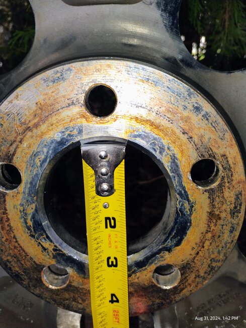

Was your list or chart for a 4-wheel drive?

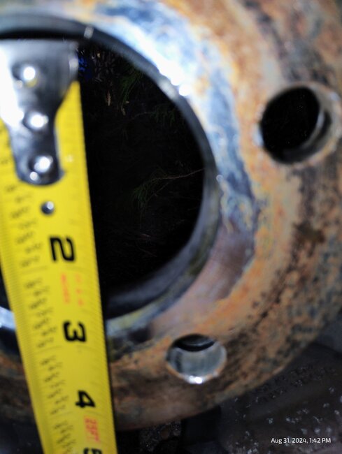

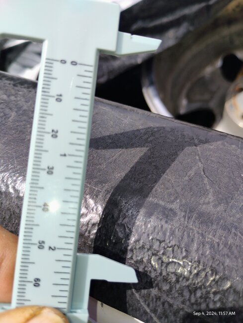

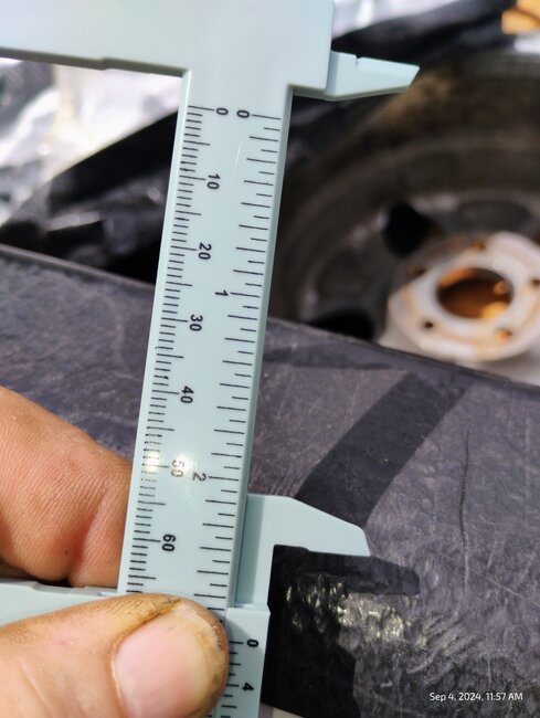

I just found out these are not originals so I will need to use a tool to measure it. How do I measure bore and offset?
Sep 3, 2024 at 8:12 AM
FLOATR925
  • 163 POSTS

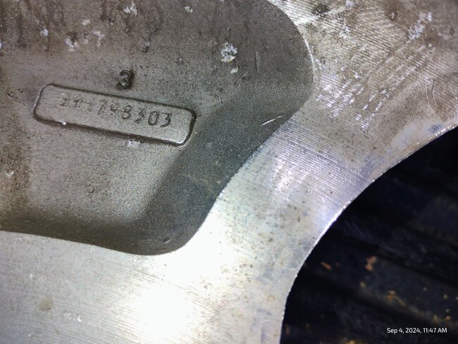

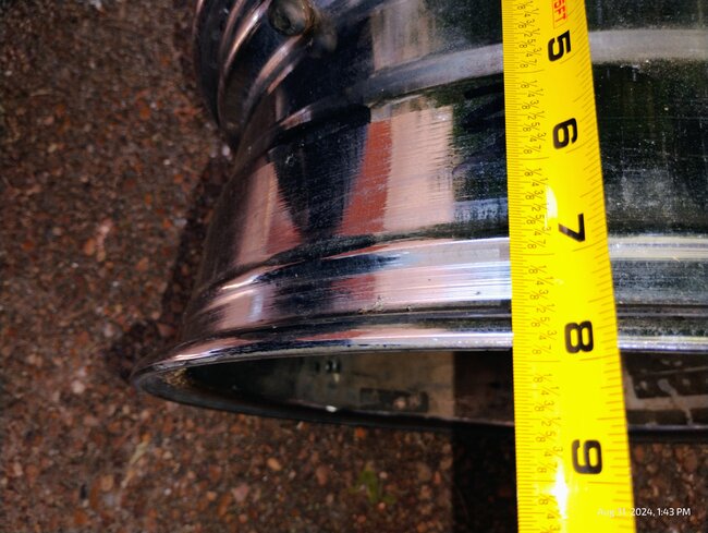

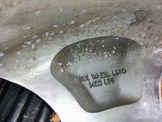

Here's what I found ..what does it come out to?
Looks like 3 inches on ground to inside of hole.up an down...that measure on pic is inside ..
8 inches wide
I found these numbers on inside ,can this somehow tell what it is?
Sep 4, 2024 at 3:58 AM
  • 55,433 POSTS
Those are the max load numbers and a part number for the rim. I am not sure about the list being 4x4. I would try to get as close as I could to the stock rim measurements, so the geometry of the suspension is not compromised.
Sep 4, 2024 at 4:07 AM
FLOATR925
  • 163 POSTS
What do you mean 4x4?
Sep 4, 2024 at 4:32 AM

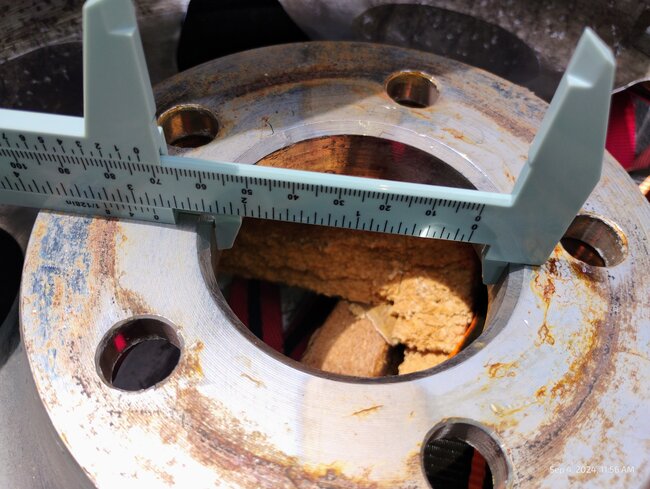

FLOATR925
  • 163 POSTS
From that measurement it looks as to be 57 or 58 mm? 2.2 or 2.4 inches?

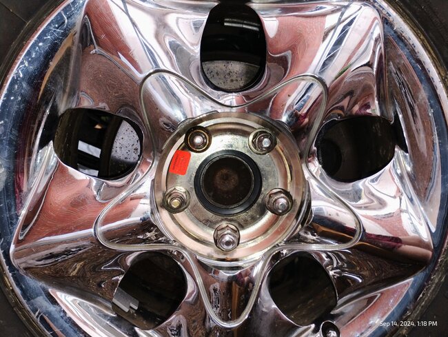

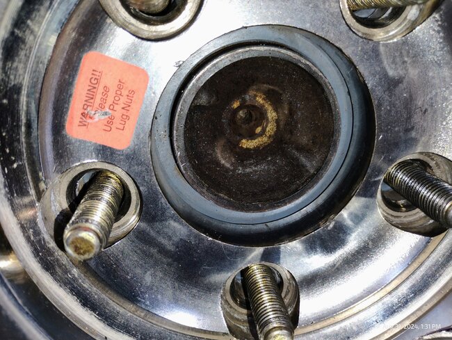

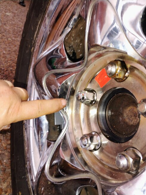

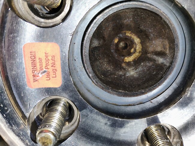

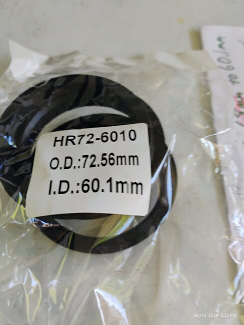

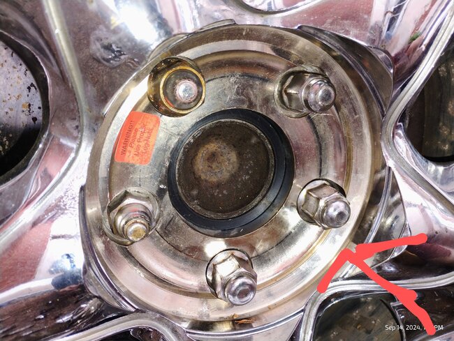

Great news, I went to a tire -custom rims shop and they measured the rim, compared it to what readings on the Tacoma information and it will work. they sold me the hub centric rings too. See size -went from 60.1 to
72.56 on hub ring ..is plastic ok vs aluminums,?. I'll get offset difference . ..
The difference is close enough on inner measure...

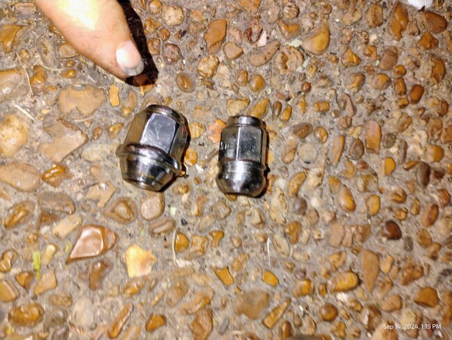

Rings for perfect ..what type of lug nuts are better for this rim ..ones that are bigger in pic or skinnier . There is a bigger hole for studs in this rim than the OEM rim...I've seen some nuts that go inside rim too but may not need them .
Also, should I have any handling issues going from 15 to 16 ,

FLOATR925
  • 163 POSTS
Which type of nut on pic would give me a better fit, wide one or thin one?
And I went from 15-inch rims to 16 inch will that change the handling or driving?
Sep 16, 2024 at 5:47 AM
  • 55,433 POSTS
I would go with the lug nut on the left. it has more of a bite on the rim.

Thanks. I gave it a test run an it did great but at 50 55 mph a slight shake in steering wheel like it slightly wiggles a hair...is that because it's 16 on rims an not 15 an higher or is that a balance issue?
Front 2 are 215 70 16 same as last but 16...rear are 225 70 16 last were 215 70 15 ..all just mounted and balanced ..I used those bigger nuts an got em at the tightest normal tightening you would any tire ..hub centric rings..
