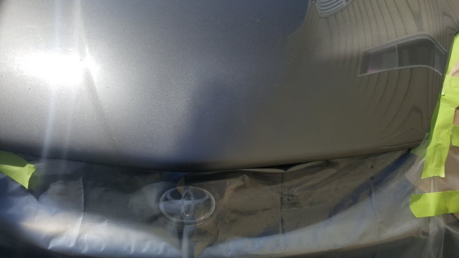

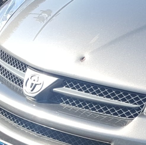

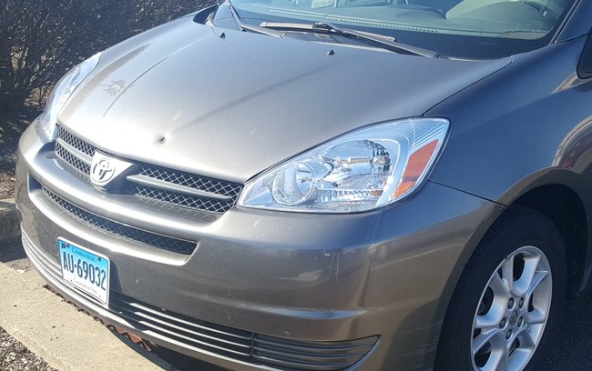

I just fixed and painted my hood on my van. As by the pictures , you can see by the first 2 pics it was a deep dent. The 3rd. picture shows the finished repaired product.
Should I had pulled out the dent with a dent puller and hammered it from the other side of the hood first before repairing and painting it?
The steps I took to repair it were as follows:
1. cleaned out the rust with sandpaper.
2. applied bondo to the dent to level it off and sand it down smooth.
3. applied glazing & spot putty and sand it down again.
4. sprayed primer on top and sand it again.

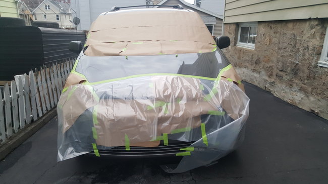

5. masked the car as in the 4th picture below for 2 weeks.
6. painted and clear coated.
Now, can I still hammer out the dent from the other side of the car. In the 3rd picture below which shows the repair done, you can't see the imperfection but up close you can somewhat see the dent a tiny bit.

To be honest, it looks like you did a good job. As far as using bondo, you always want to use as little as possible. When you put a lot on, it is more pron to crack. However, since the dent wasn't too big in diameter, you should be fine.

To echo Joe, it looks pretty good for not being a bodyman. The small imperfection is likely due to sanding, The hood has a rounded profile in that area. When you filled in the ding with the bondo it was softer than the metal. That means it made a flatter area because of the softer bondo sanding away while the metal was acting as a bridge. That is one of those things you only get used to with a lot of practice.
Congratulations.

Not at this point. You do all metalwork prior to anything else. If you try moving the metal now the repair you have done will fail as the bondo will not bend with the metal, it will simply pop free and you would need to start over.
Plus with that being a double layer hood you would need to use something like a slapper bar and dolly to get between the layers and move the steel.
