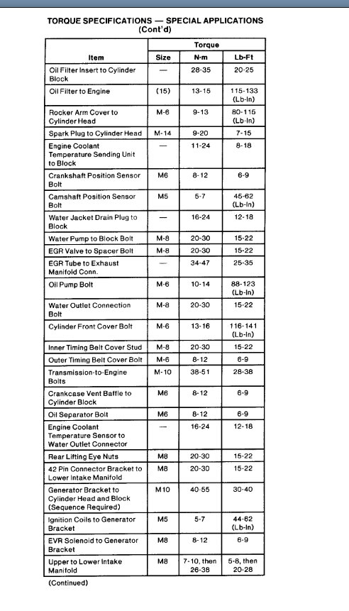

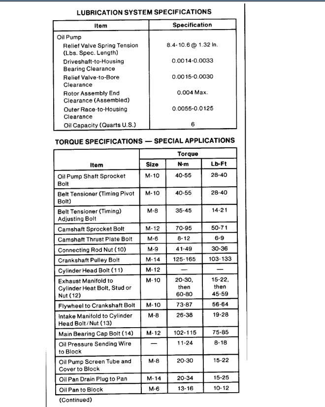

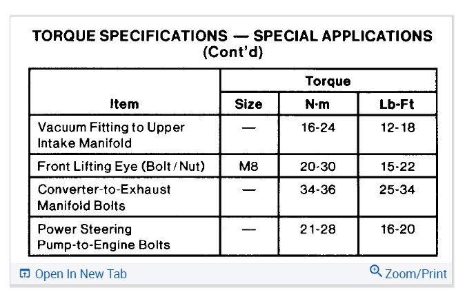

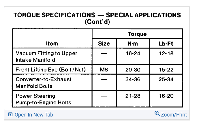

I need the Bolts Torque Specs Charts for the whole truck (engine and components, transmission and components, body parts, frame members, differential components, front & rear suspension components, etc.,). Thanks for your help.

We only handle one subject at a time. So, here are the torque specs for the engine. please start new question of the additional subjects. Check out the images (below).
