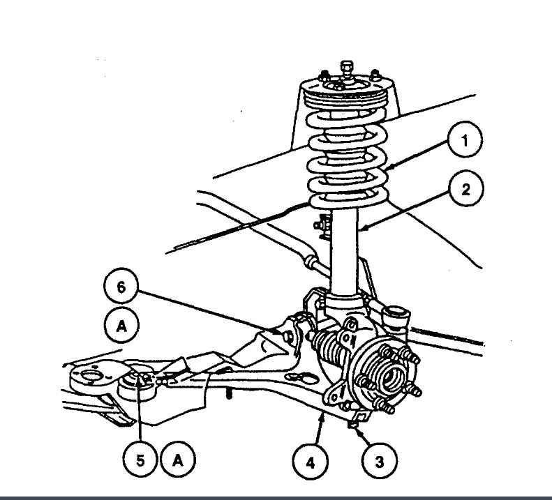

Why is the bolt facing engine down. nut closest to the ground Reasoning behind bolt is supposed to be like that.
Dec 29, 2019 at 2:38 PM
  • 110,244 POSTS

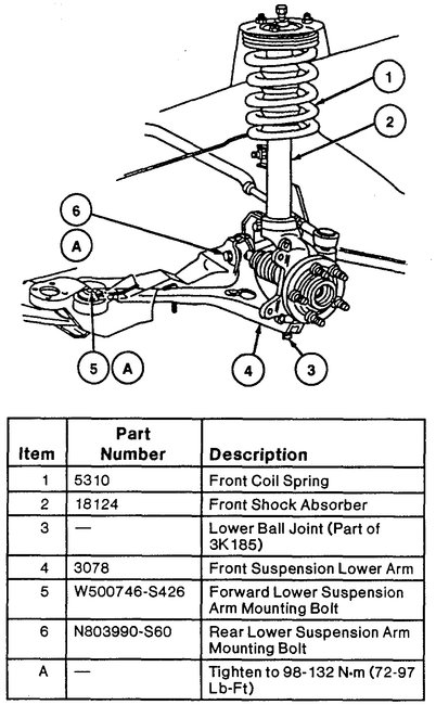

I'm not sure which bolt you are referring to. Here are the directions for replacing the lower control arm. The attached picture correlates with the directions. Take a look at the pic and let me know specifically which bolt you are referring to. I suspect it is number 5 in the pic.

1. Position front suspension lower arm into front sub-frame. Install forward and rear lower suspension mounting bolts and nuts. Tighten rear bolt to 98-132 Nm (72-97 ft. lbs.). Tighten front bolt to 77-103 Nm (57-75 ft. lbs.).

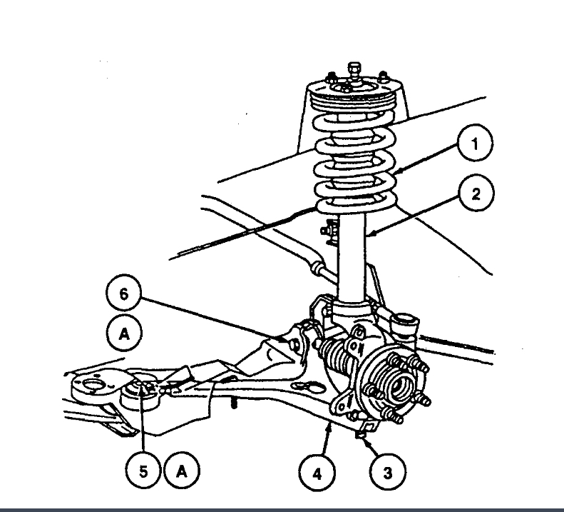

In attachment pic 5A for nut on top or bottom of frame does it matter and why if so?
Dec 31, 2019 at 12:19 AM
  • 110,244 POSTS
I just went through the directions. I see nothing indicating it has to be a specific way. If it was mine, I would face the nut in the directions it would be most easy to access. Here are the directions right from Alldata:
