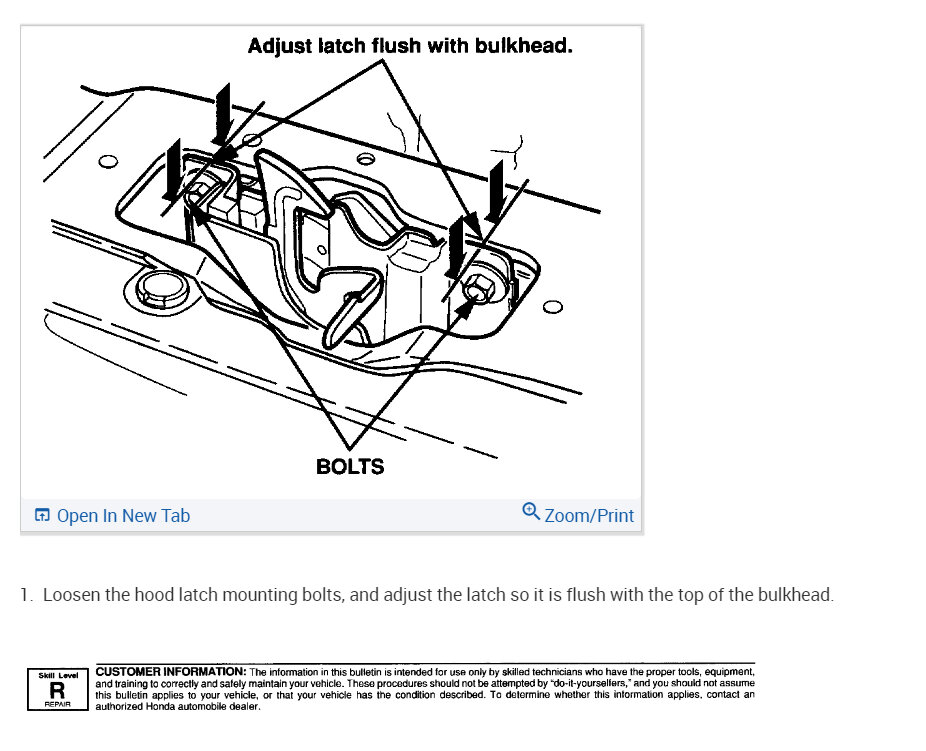

What size bolts, three of them are the hood latch bolts?
1999 HONDA CIVIC
280,000 MILES • 4 CYL • 2WD • AUTOMATIC
CRAIGC8822
what size. bolts. Three of them are the hood latch bolts that you use to mount the locking bracket.

This should be 8mmx1.5 thread size x 16mm in length here are instructions that may help as well. Check out the images (below). Please let us know if you need anything else to get the problem fixed.
