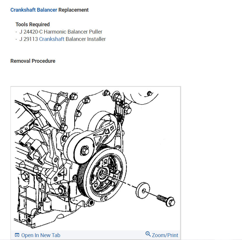

I cannot get the crankshaft balancer bolt out

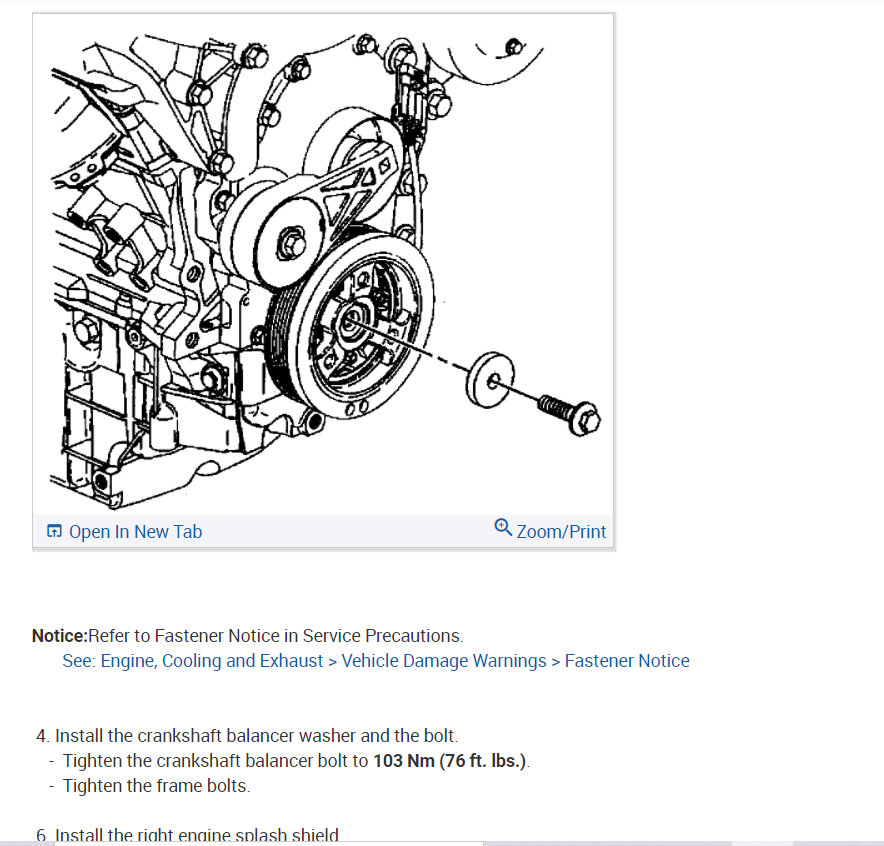

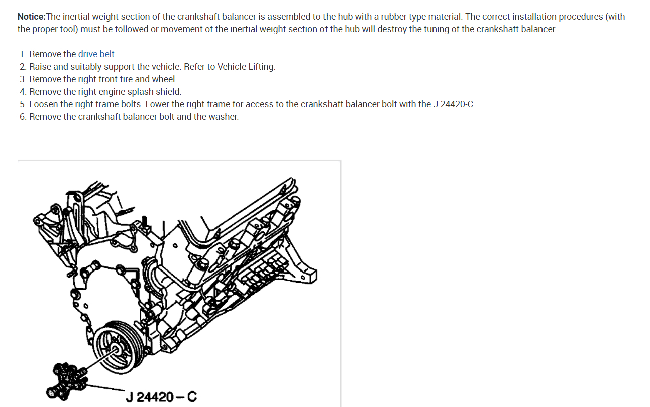

I've tried an impact wrench, I have tried a breaker bars, I've tried everything. I've broken sockets are broken bent 2 bolts. Please if you have any ideas let me know I don't know what to do with it.

Good morning,
The bolt is only tightened to 76-foot pounds. That is less than a tire lug nut.
You need a powerful air gun or electric air gun to release it. It turns counterclockwise to remove it.
https://www.2carpros.com/articles/how-a-harmonic-balancer-works
