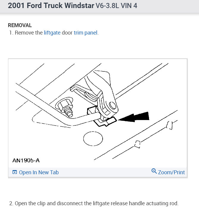

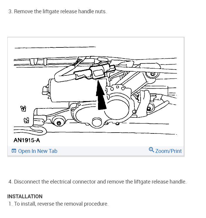

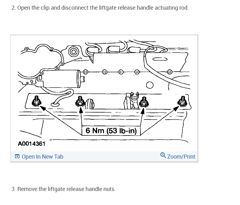

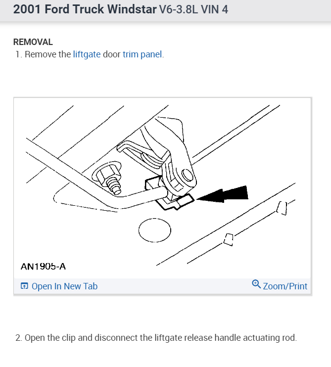

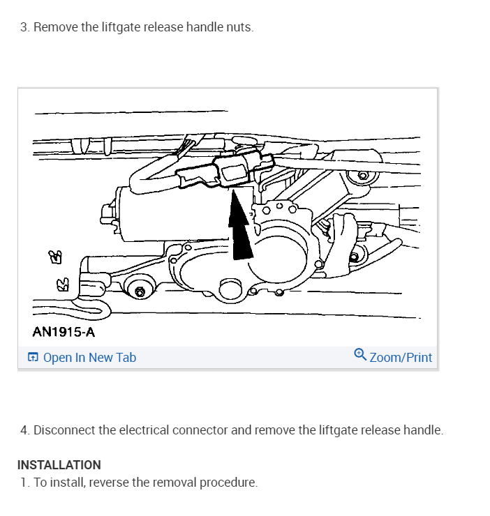

I am trying to remove the rear door panel from inside the van to repair the door latch. Does anyone know what size of bolt is used to attach the rear liftgate handle to the panel? I have a ratchet wrench that will work but need to know the bolt size inside the handle. Thanks for your help. :)

This bolt size should be a 10mm, I have also included the instructions on how to change the handle out in the diagrams below. Check out the diagrams (below). Please let us know if you need anything else to get the problem fixed.
