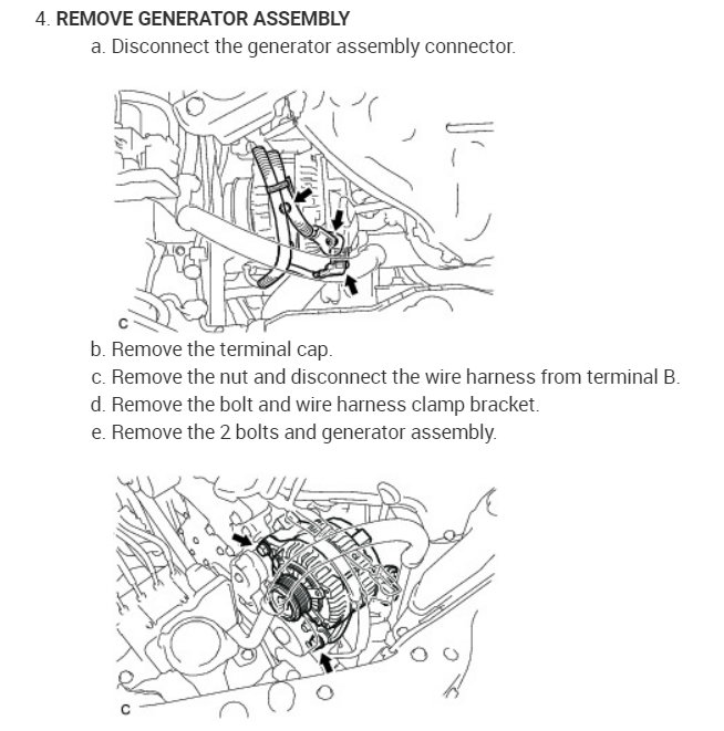

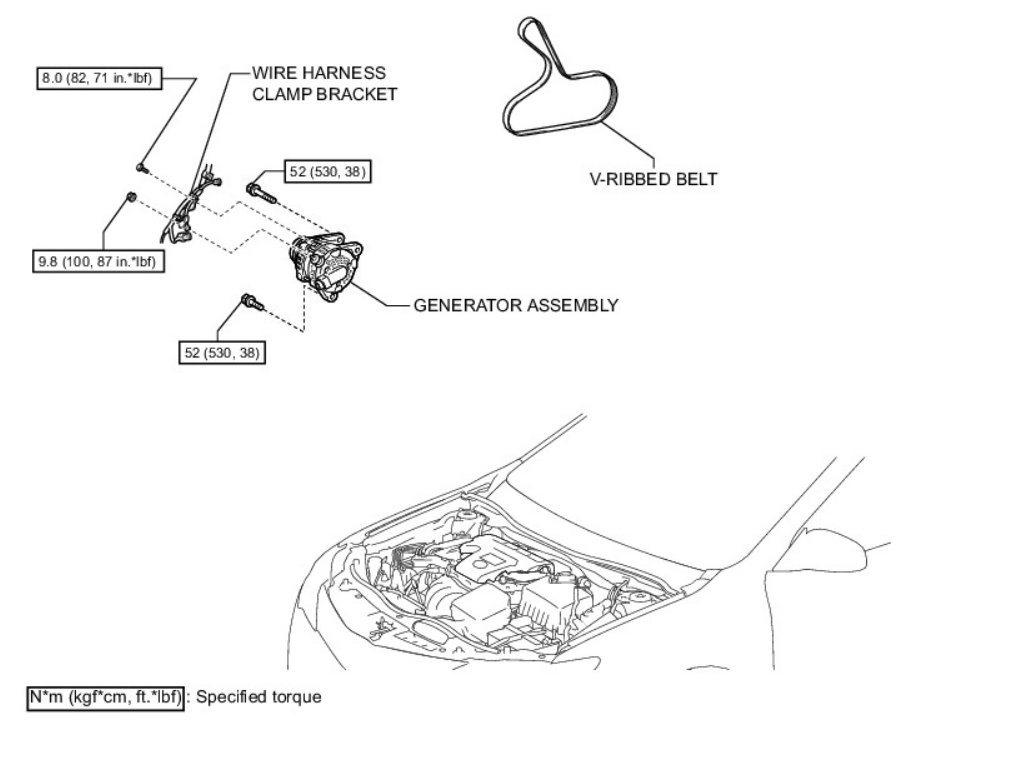

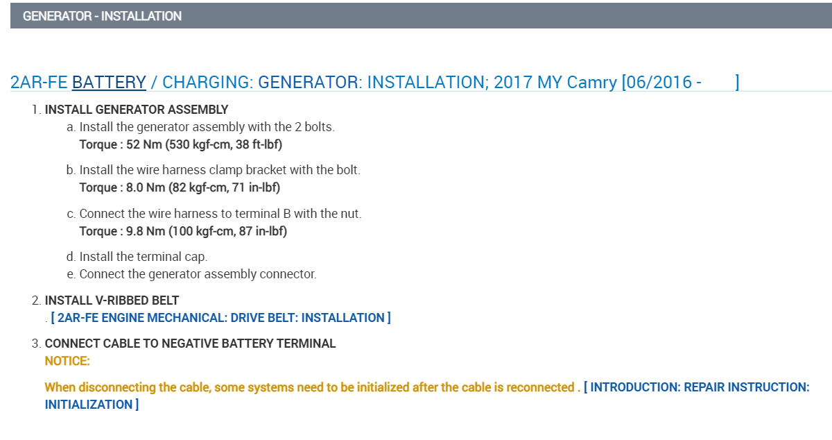

I took my alternator off and misplaced my two main bolts. What's the lengths and sizes of the bolts?

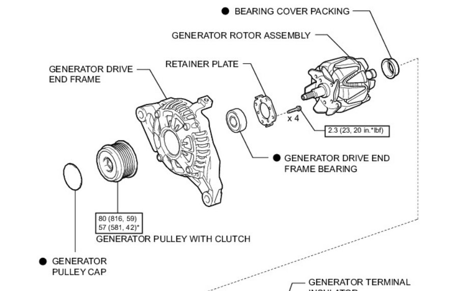

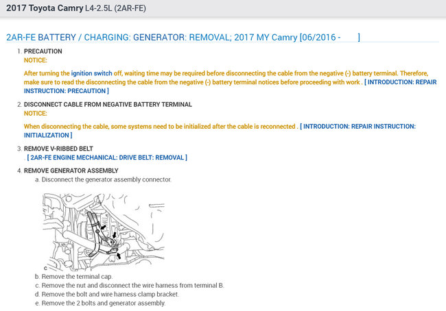

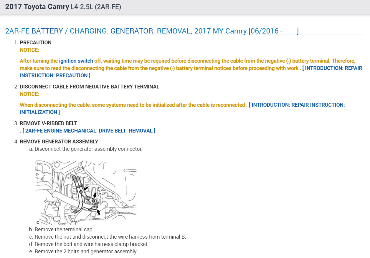

That might be difficult to find out, you maybe be able to call the dealer to get the bolts or look at the directions the manual gives you so you can estimate the size. check out the instructions in the diagrams below. Please let me know how it goes. Check out the diagrams (below). Let us know what happens and please upload pictures or videos of the problem.
