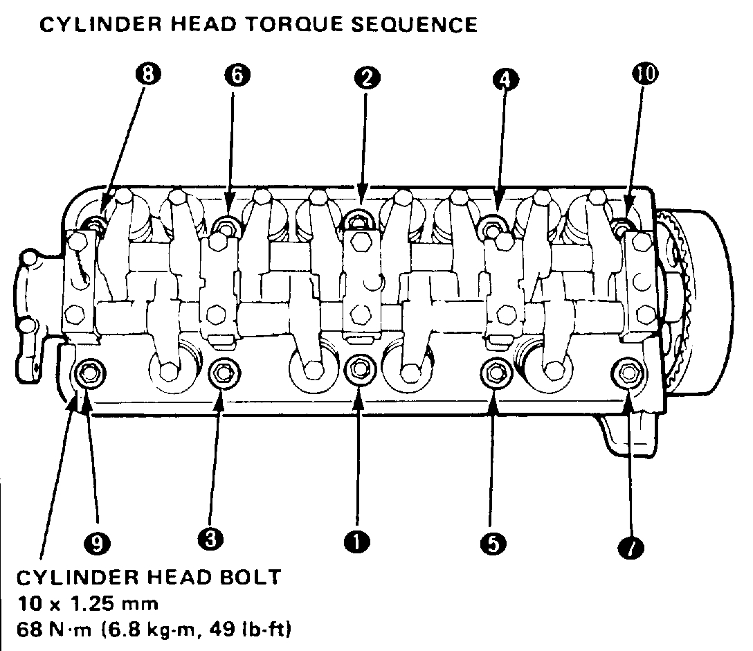

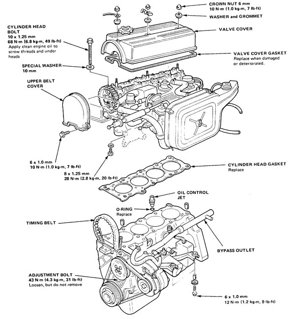

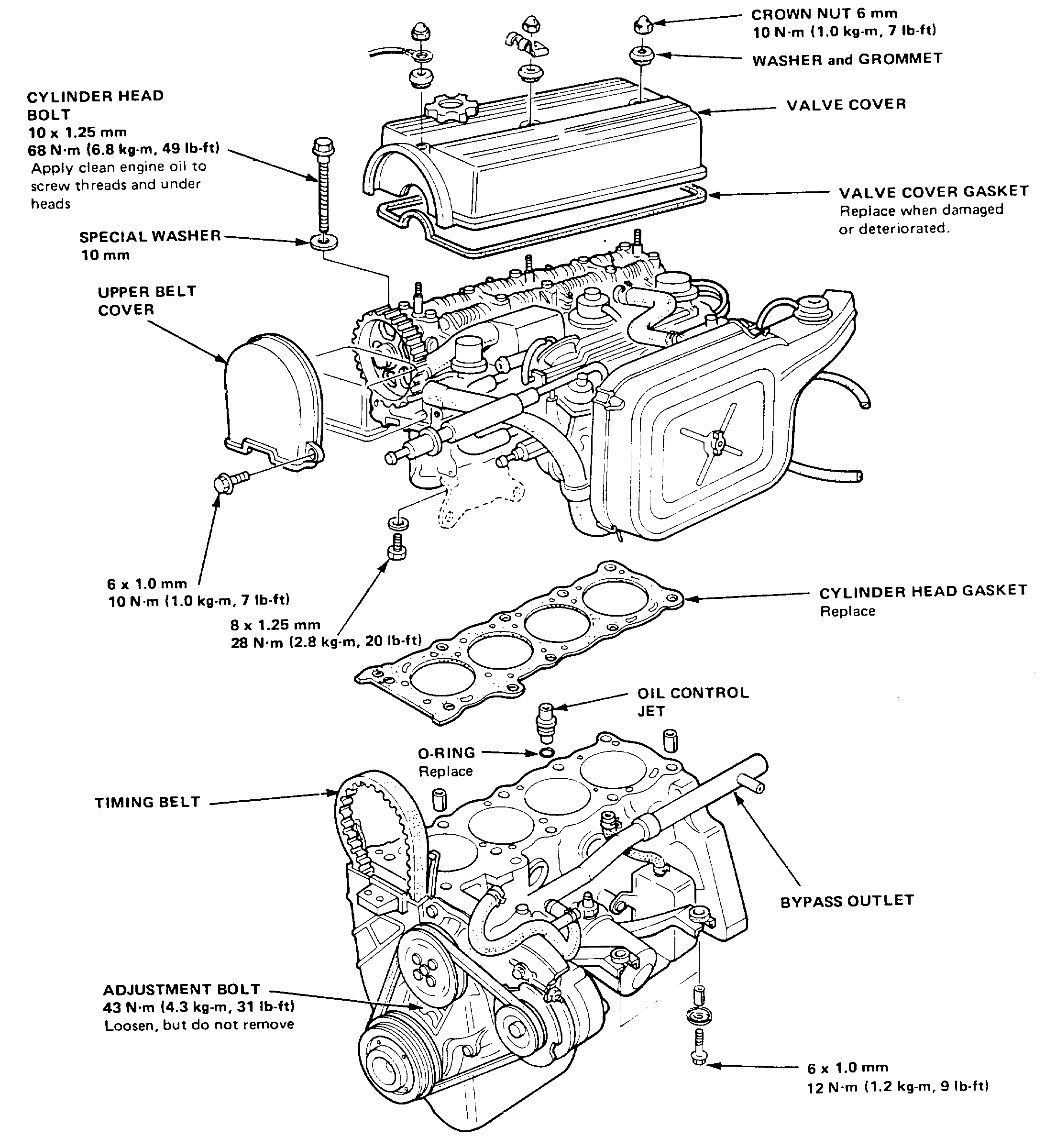

Hey, so, I just began working on my engine on my var listed above EX model and got a spark plug completely rounded I now need to use an extractor but I need to drill the plug out.
Thats why I want to know the bolt sequence and torque spec of the head, I need to remove the head to clean the parts of the plug that will fall in the cylinder
Thanks !

Here an image of the assembly with bolt torque specs.
Aug 21, 2025 at 3:40 PM
MECHTRIX
  • 393 POSTS
Here the torque pattern hope you remove the plug and not need this but here it is just incase ..that said if you need help with removing it and saving a lot of unnecessary work ..i might be able to help ..good luck

Youl also need the torque specs for the intake min8fold and the exhaust manifold ..and cam caps
