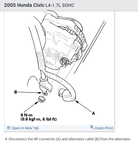

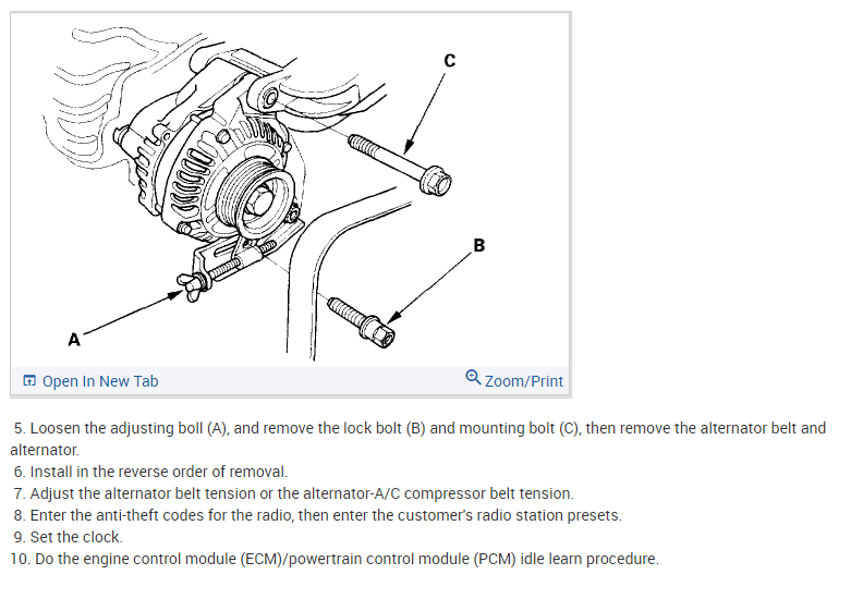

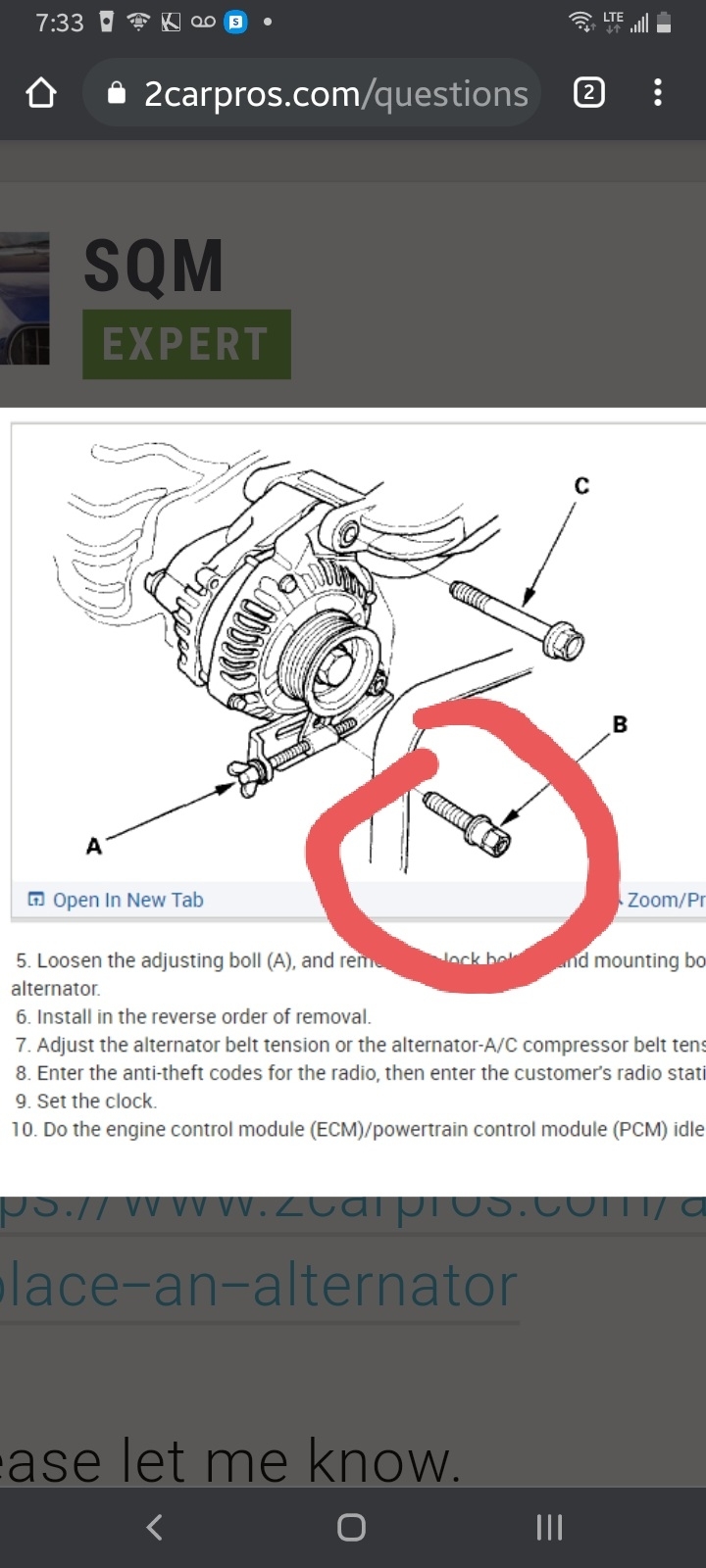

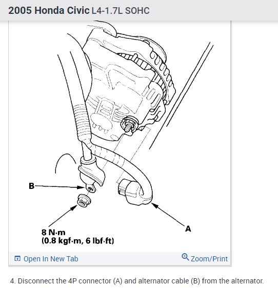

What is the rubber piece that goes on bolt b in the diagram called?

Did mean to upload a diagram? I do not see a diagram with your question. Is it a mounting bolt or bolt for the wire?
I uploaded the alternator replacement diagrams for your reference.
https://www.2carpros.com/articles/how-to-replace-an-alternator
Please let me know.
Aug 26, 2021 at 11:39 PM
ALISHAG
I apologize.. it is a bolt for the wire. Thank you for working with me.
Aug 27, 2021 at 10:40 AM
SQM
  • 6,383 POSTS
No worries. Yes that is locking bolt for the adjustment. It is many times gets seized.
