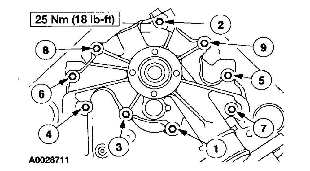

Someone else took the water pump off my friend's van and put all the bolt and nuts in a bowl. now can't figure out what bolt goes where. is there anyway to find out what goes where?
Apr 25, 2020 at 5:53 AM
Good afternoon,
I attached a picture and the location of the installation of the studs and the nuts. The short bolts will go into the remaining holes.
1. Note: Use pipe sealant on studs No. 4 and No. 6.
Install the water pump with a new gasket.
Install a 135.5 mm stud at location No. 5 and tighten to 7 Nm (62 inch lbs.).
Install a 137 mm stud at locations No. 4, 6, 7 and 8, and tighten to 7 Nm (62 inch lbs.).
Tighten the nuts and bolts in the sequence shown.
