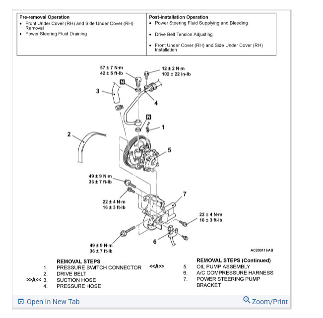

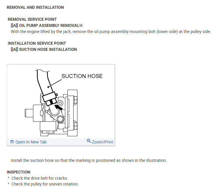

I noticed a couple weeks ago my power steering reservoir fluid was boiling, like excessively.
What can cause this? Because today my car made a loud like squealing noise like when you have a loose belt. then it progressed into a terrible loud almost like grinding. I don't know or like the sound your car makes when radiator blows. But mine didn't .I drove 2 blocks turned car off and got it towed home.
Any ideas?
Maybe the power steering fluid isn't related. but then maybe it's a pre- curser.
Any help is greatly appreciated. Thanks
Attached is my current.

Good morning,
This sounds like the power steering pump itself. The pressure may be too high or there is a restriction in the lines causing this issue.
https://www.2carpros.com/articles/power-steering-problems
https://www.2carpros.com/articles/power-steering-fluid-flush
The pump would be the first thing that needs to be replaced. The system will need to be flushed as well of all the old fluid.
https://www.2carpros.com/articles/how-to-replace-a-power-steering-pump
Even after the pump is replaced, there is a possibility the rack may have been damaged. The seals internally may have been damaged.
