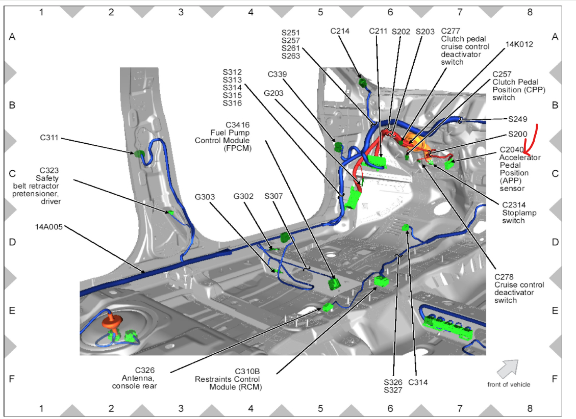

Sure, I can help you :) to me it sounds like the engine is going into limp mode, let's run the codes to see which ones are stored so we can go in the right direction to fix it. Here is a guide that will help. I have seen the accelerator positions sensor cause this issue. This guide can help:
Here is the location of both the accelerator positions sensor in case a code is present for it.
This guide can help as well:
https://www.2carpros.com/articles/reduced-power-limp-mode
Check out the images (below). Please upload pictures or videos in your response of any problems so we can see what to help you with. The sensor is basically the gas pedal.
