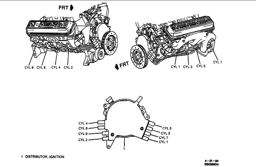

I recently bought the vehicle listed above (wagon) that had been sitting for a while. It drove nice for a little while but now it's starting to shake and misfire.I changed the spark plugs and checked the wires hoping that that would fix the problem. But it seems to have made it worse. Now it starts and idles like perfection. But you can hear a difference in my passenger tailpipe. It kinda chugs instead of a smooth constant sound. It also shakes but no it doesn't want to accelerate and powers down.I checked the oil and it was a little dark so I'm going to change that. And I checked the transmission fluid as well and it seems to have had been overfilled, but it was running fine before so I'm not sure if that's to blame.

Good evening,

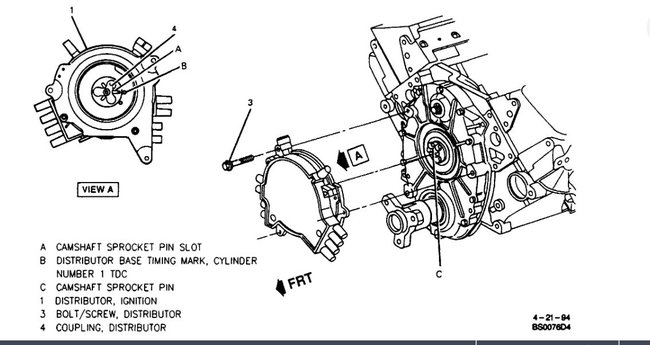

This motor has the distributor on the front of the motor in the timing cover.
This was probably the worse idea an engineer ever had. The issues were the water pump. The pump leaks out the weep hole right on to the distributor and causes all kinds of running issues especially under load. they even put a drain hole in the distributor for when the pump leaks, the water will drain out of the distributor.

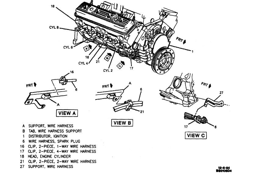

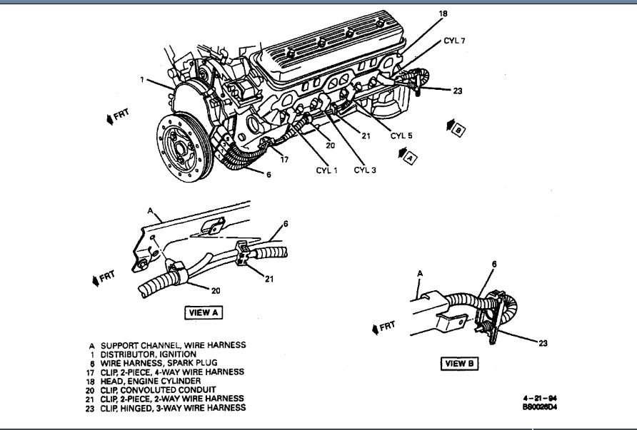

I know you checked the wires but I would replace them. That is another engineering goof up. they are extremely tight and routed next to heat.
My suggestion is to change the cap and rotor and look for rust in the distributor. If there is, replace it.
Change the wires as well.
