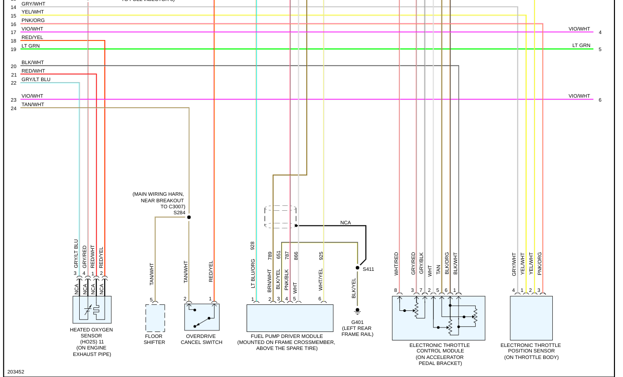

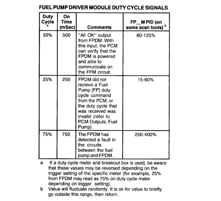

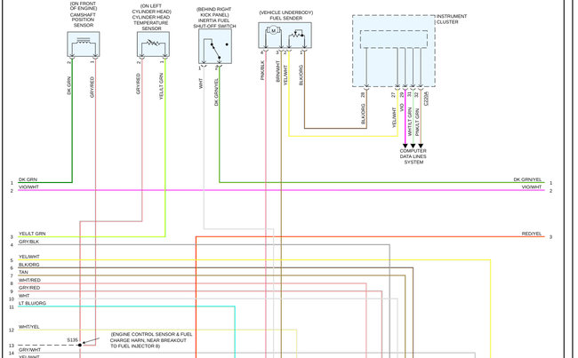

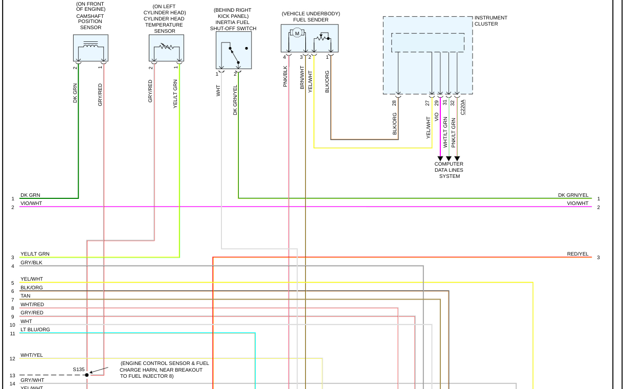

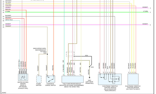

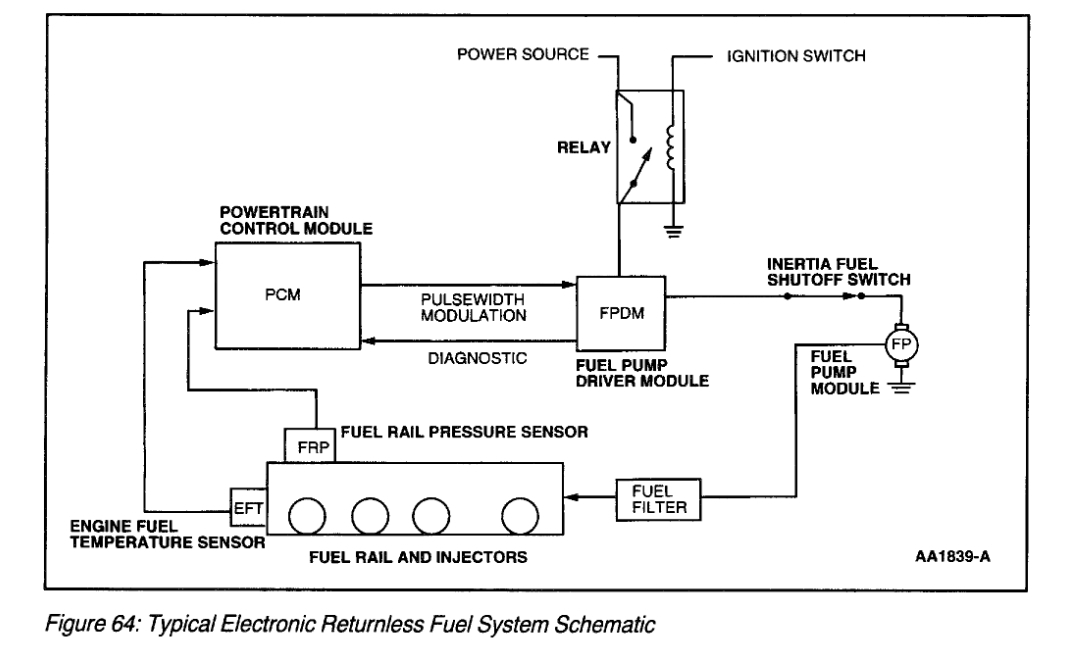

It could also be the Fuel Pump Driver Module used on returnless fuel system. It's located above the spare tire on the left side frame cross member. Remove it and check the back side of the module they are made out of aluminum and corroded through causing voltage drop to the fuel pump. I'm attaching a schematics and wiring diagram below for your reference. The wiring diagram is cut into 2 hafts for easy viewing. let us know if you need more info.
Thanks
Joe T.
