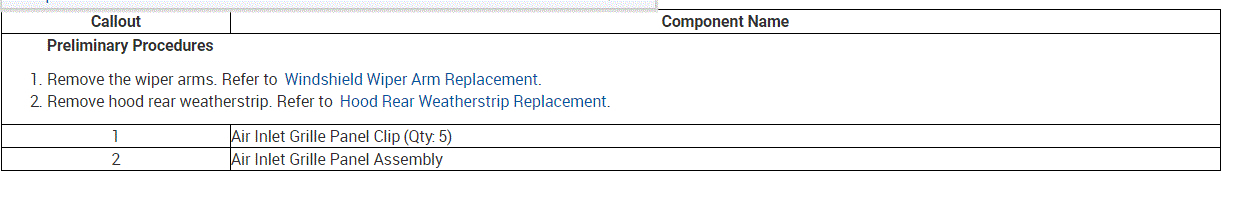

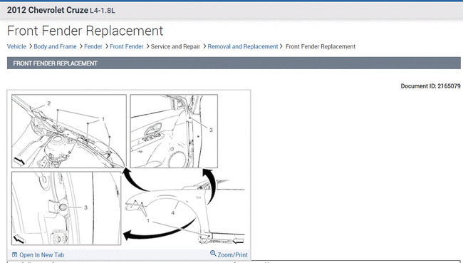

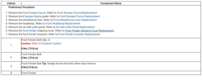

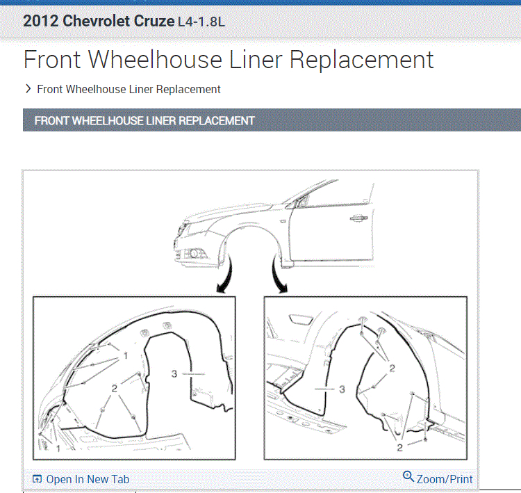

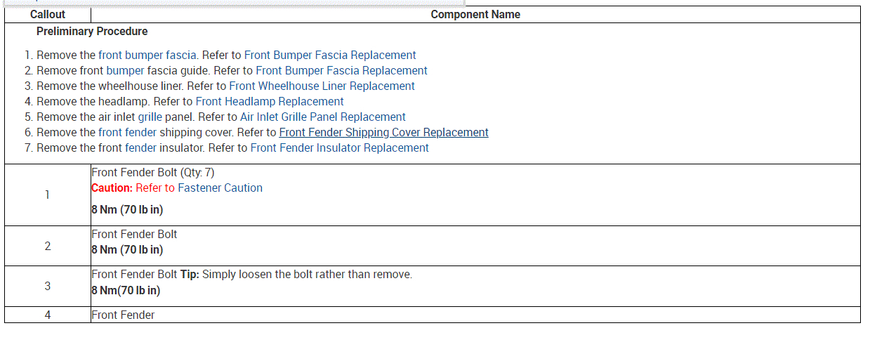

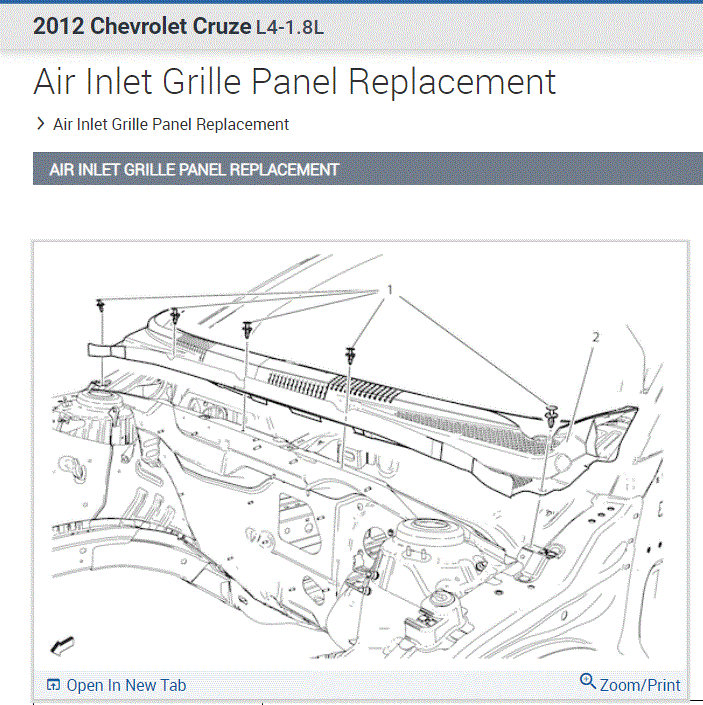

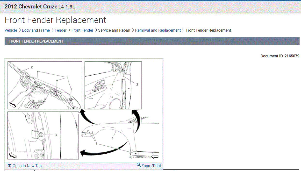

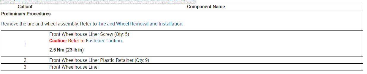

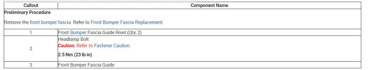

Looking for detailed instructions on how to repair and replace left front fender.
Mar 17, 2021 at 6:14 PM
  • 110,194 POSTS

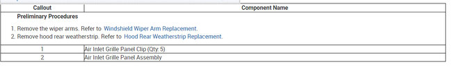

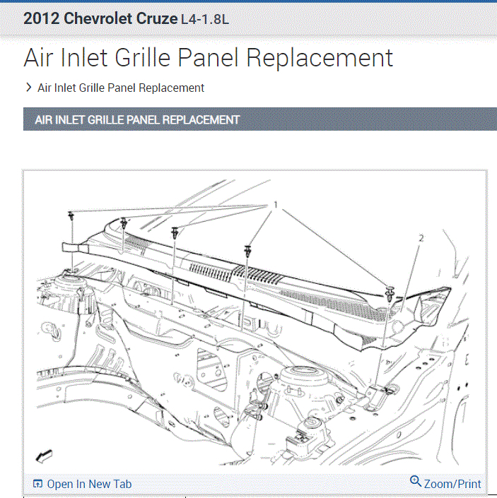

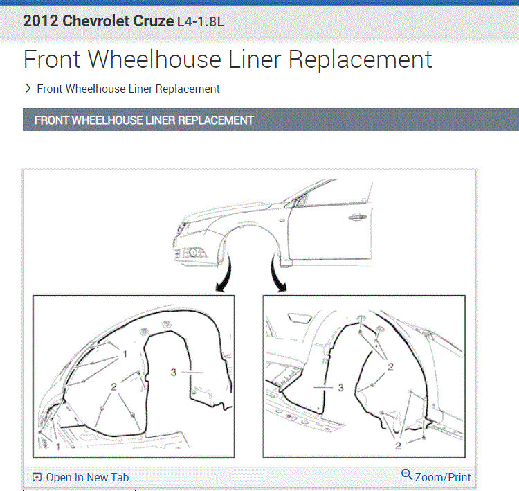

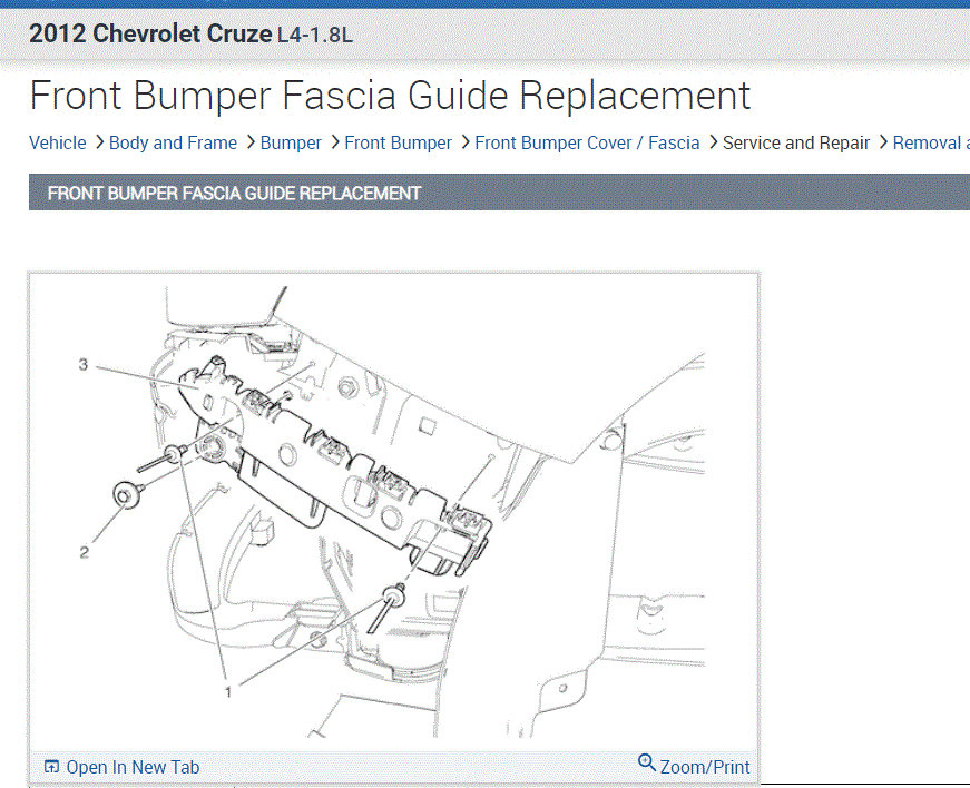

To remove and replace a front fender will require other things to be removed. If you look at the first two pics below, they provide the directions and pic related to fender replacement. The remaining pics and directions are for the other components related to this procedure.
Again, check out the pics below for directions.
