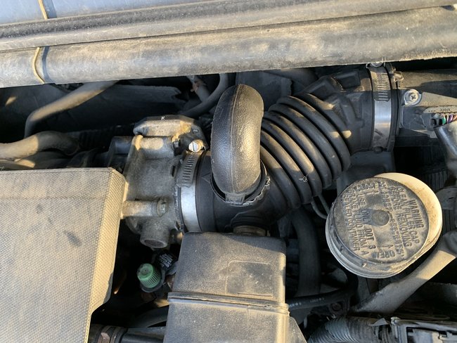

Hi, I have been trying to remove the body throttle and tried a few times. I remove the 4 nuts as shown in YouTube videos, but the body throttle will still not come off or even move at all. Am I missing another screw somewhere I don't see or I am missing something to remove after the 4 screws for body throttle to come off? Please help.

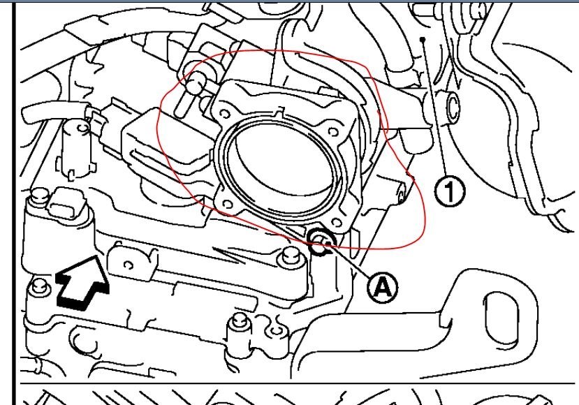

Most likely the o-ring is sticking to both the throttle body and the intake.
Did you remove the coolant hoses attached to it?

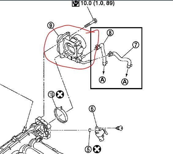

I posted a couple of pictures for you. There are only 4 bolts that hold the body. Make sure the bracket in the second picture is out of the way.

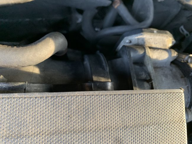

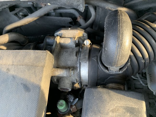

Attached some pictures to show you. I did everything you said but it didn’t come loose.
Feb 24, 2020 at 6:47 AM
The bolts are still attached.
After you remove the bolts. tap on it with a hammer to break it loose from the seal.
