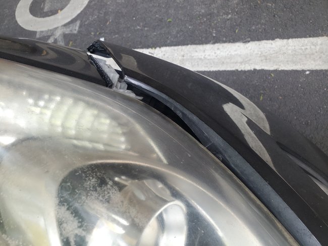

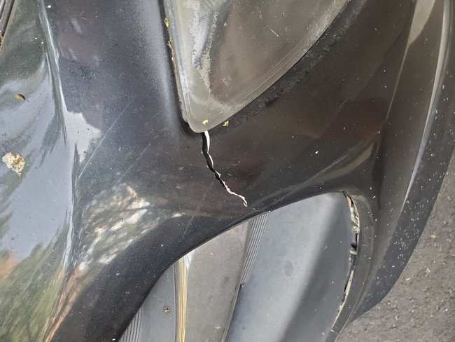

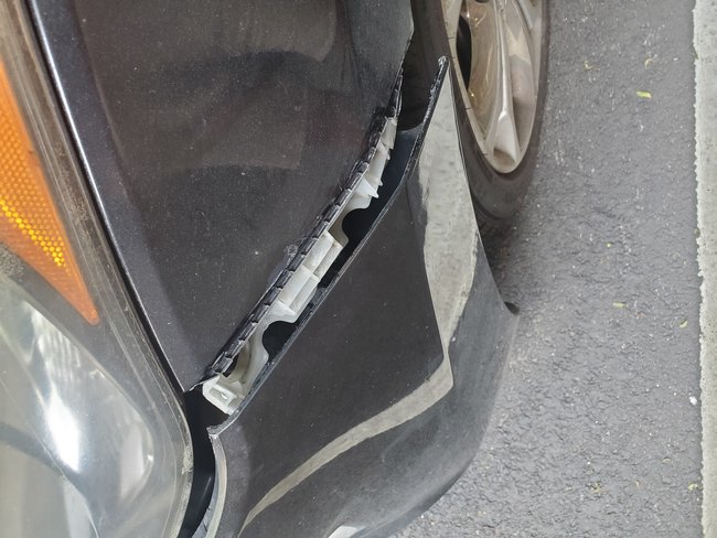

Hit a small animal on a freeway on the side of the front bumper. Just wondering what's the cheaper way to fix that section that came off a little bit on the driver's side.

Could you take a few pics and upload them for me to see? I'm not sure exactly what is broken.

The bumper cover is basically held on with plastic clips and a few bolts. The most inexpensive way I can suggest is to find a used one. What would make it even better is if you could find a black one.
If you can't, the new cover would need to be painted to match.
If you look below, I provided the directions for removing and reinstalling the bumper cover. Take a look through them and let me know if they help or if you have questions.
