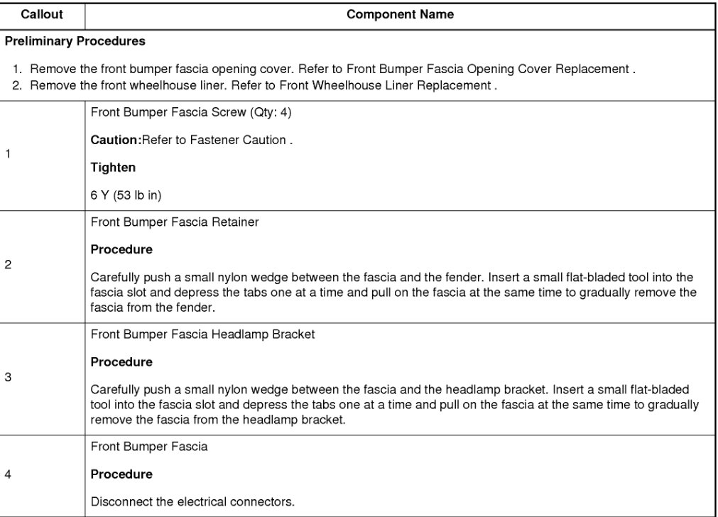

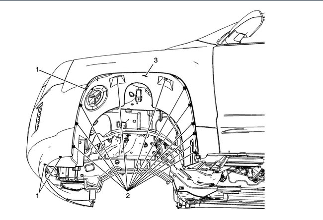

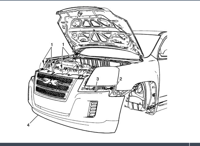

Wife had a fender bender. Front bumper cover and passenger fender were damaged.. Ordered the new parts and just got back from paint shop. Any guidance on removing the old and putting on the new would be helpful. Not much of a body guy but can usually figure things out pretty quick.

The best I can find is for the bumper cover. If you look at pics 1 and 2, they show the procedure and where the mounts are located. Pic 3 shows the inner fender push pin locations for removal. If you have to replace the fender, the inner fender needs removed.
As far as the fender, I don't have any pics of bolting locations. However, if you open the hood, you will see how it is bolted ti the inner wheel house. Also, there will be bolts at the bottom behind the wheel and if I recall, behind the headlamp and between the door and fender.
Let me know if this helps or if you have other questions. As far as bolting locations for the fender, check the new one and you will be able to tell where they are located.
I hope this helps.

Got it done today. Images helped a lot. Also found out many of the items the auto body shop quoted were not broken. I saved over $2,000.00 doing it myself. Looks like a new truck again.
