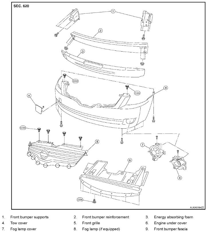

Pulling up to bank i sideswiped a brick planter took the front fascia lower clean off.. i'm probably going to need some advice on repair. i felt like i barley tapped the brick planter. lower front clean off. i recovered whole thing.

They are not held on by much. Something like 8 screws and some push pins. You will want to look at the attaching points to see if any are torn or damaged. Sometimes you can use something like a fender washer if the screws pulled through the material.
