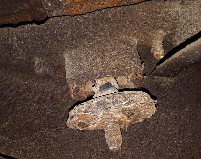

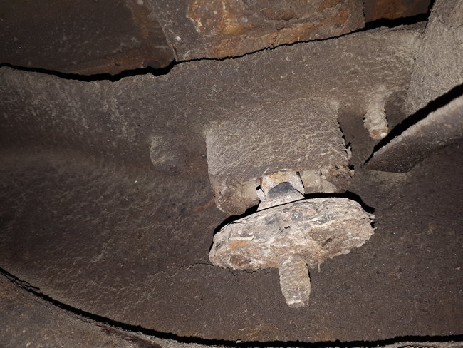

The van body mounts are totally shot. I don't even have a photo of what they should look like. I want to fix it up good or better than new. I cannot find new mounts anywhere. I thought we should jack the van up, remove all the bolts and replace one mount at a time. Any information would be greatly appreciated. The mounts seem about 4 1/2 inch by 1 1/2 inch with rounded ends. Please Help.

Hi Danny: Unfortunately these just won't fit. They are round and the original ones are not. The original ones are 1 3/8 by 2 ¾. Sort of rectangular with rounded ends. As shown in the photo I sent the bottom mount fits inside a fitting bolted to the frame.

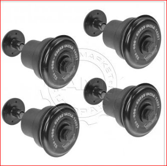

These are from Dorman as well. Do these look like the ones? I've attached a photo. Hope this helps and thanks again for using 2CarPros.

It kind of looks like it might fit but it doesn't. I bought the set from Rock Auto and had to send them back. The four back mounts on my van are 1 3/8 by 2 3/4 inch, sort of a rectangle with rounded ends. The back four mounts fit into a sleeve sort of thing bolted to the frame.

These should be the ones. Look at the end circled in red(picture attached).Rectangular with round ends. If not, have you contacted a local Ford dealer? Hope this helps and thanks again for using 2CarPros.

Ford has some of the parts. I had the entire Dorman set here. I bought it from Rock Auto. The one with flat sides (and there was only one) was not the right size. I wound up losing about $100.00 CDN on shipping both ways. The nasty people at Rock Auto said I should have known by the photographs that the mounts were not the ones I needed. The Ford dealer has some of the mounts not all! Also none of the bolts! According to Rock Auto and Dorman their mounts fit Ford E-150 until very recently, if that were true Ford would still have stock. I have joined a couple Ford Groups just today looking for input as to what will work. If you can find out anything I would be grateful. Thanks Mike
