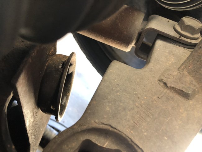

Missing from both sides.

That would be the engine mounts need to have them replaced. Open hood engine running place foot firmly on brake drop in gear tap accelerator if engine jumps up and falls back then mounts are bad.
