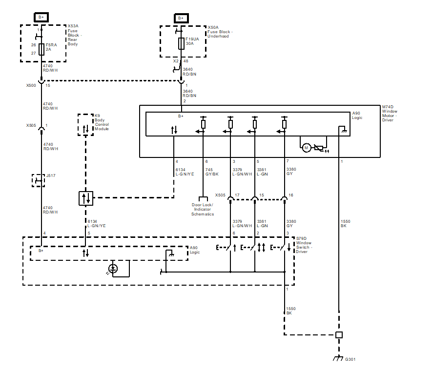

I had a diagnostic done and was told my body control module failed but can't find its location. Where is it in the car listed above? I thought glove box or center console area. I can't figure out how to remove the glove box so hopefully someone can help. The only problem i'm having is the drivers window switches are not working. so had diagnostic done and came with body control module issue. Can you help guide me to its location?

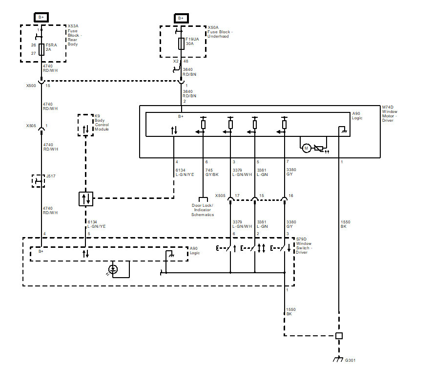

The driver window switch is not controlled by the BCM, body control module.
Suggest to first check both fuses, F5(2A) in rear fuse block in boot and F19(30A) in under-hood fuse block.
See diagram below.
Cheers, Boris
