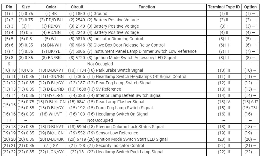

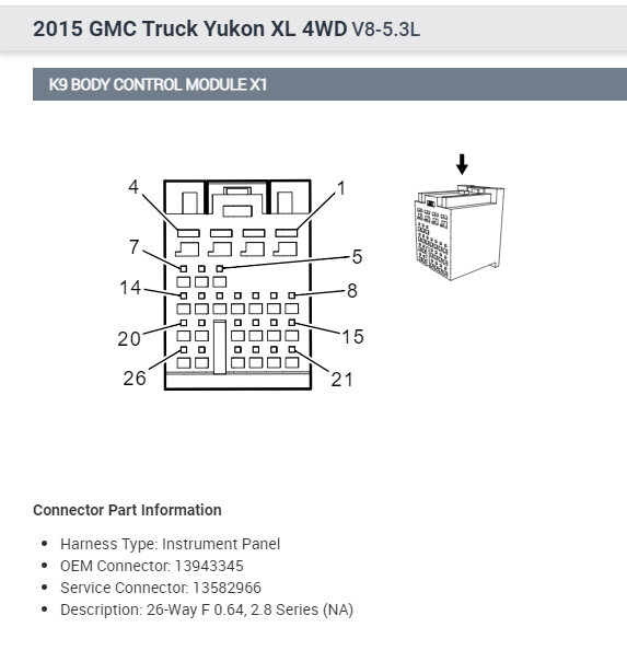

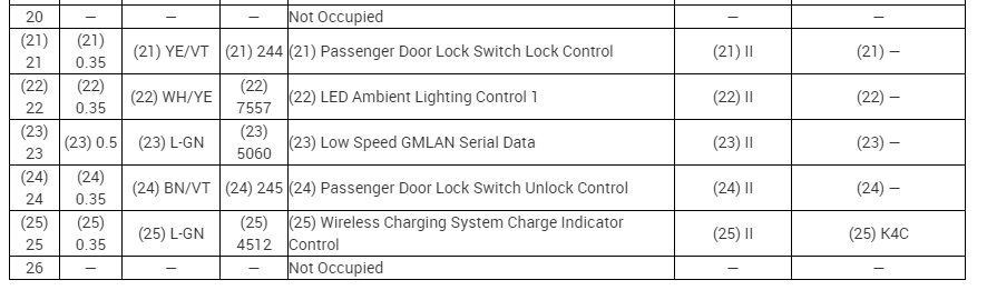

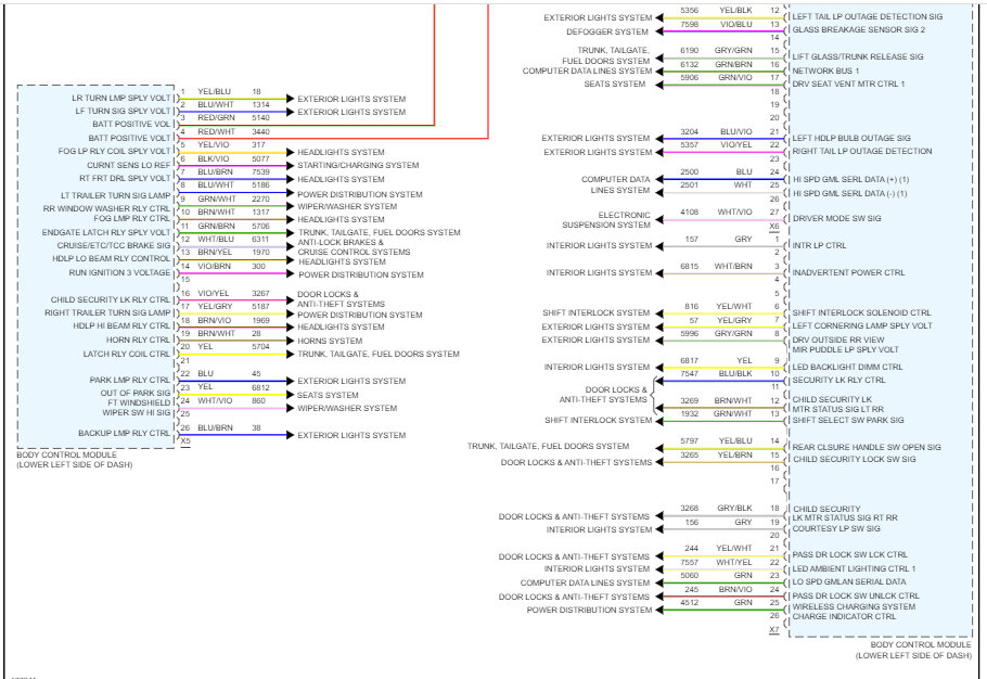

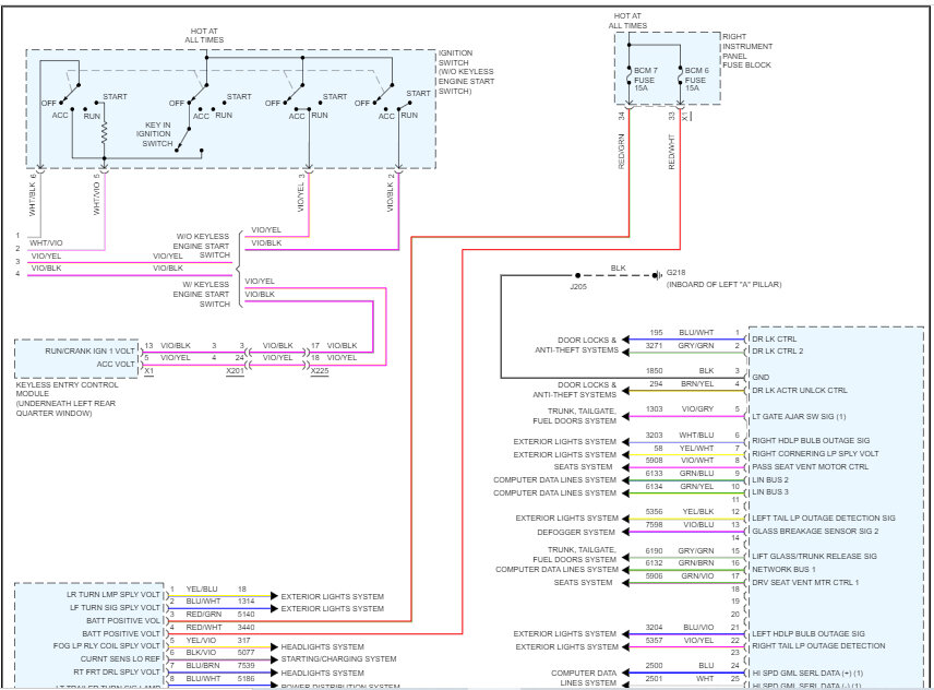

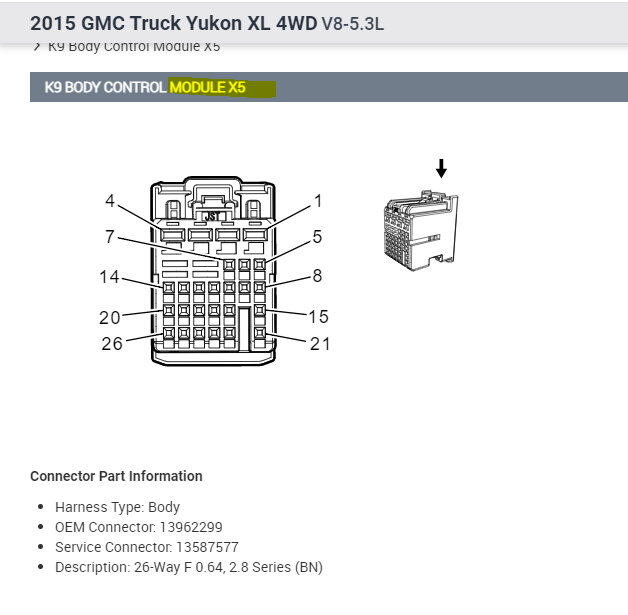

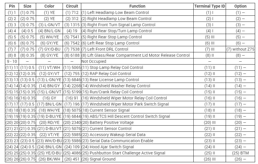

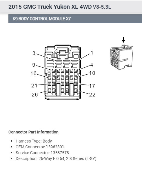

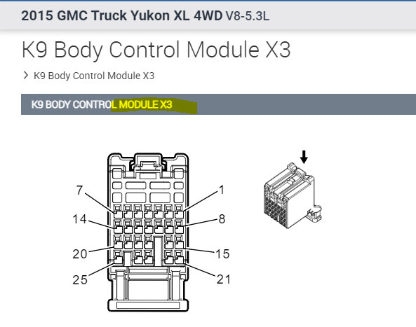

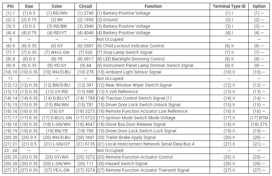

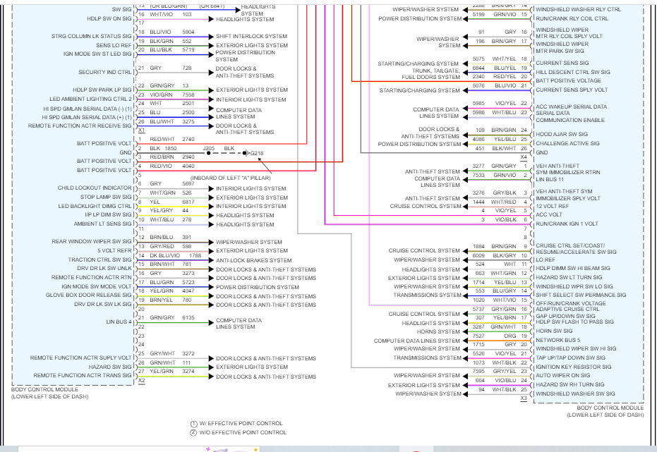

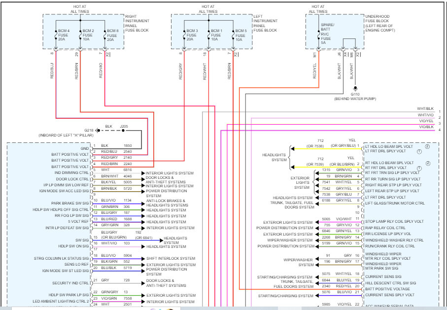

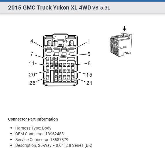

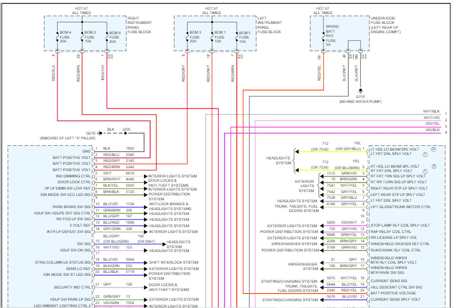

I hope I got the right one. I went with a 5.3L 4wd. If that is wrong, let me know.

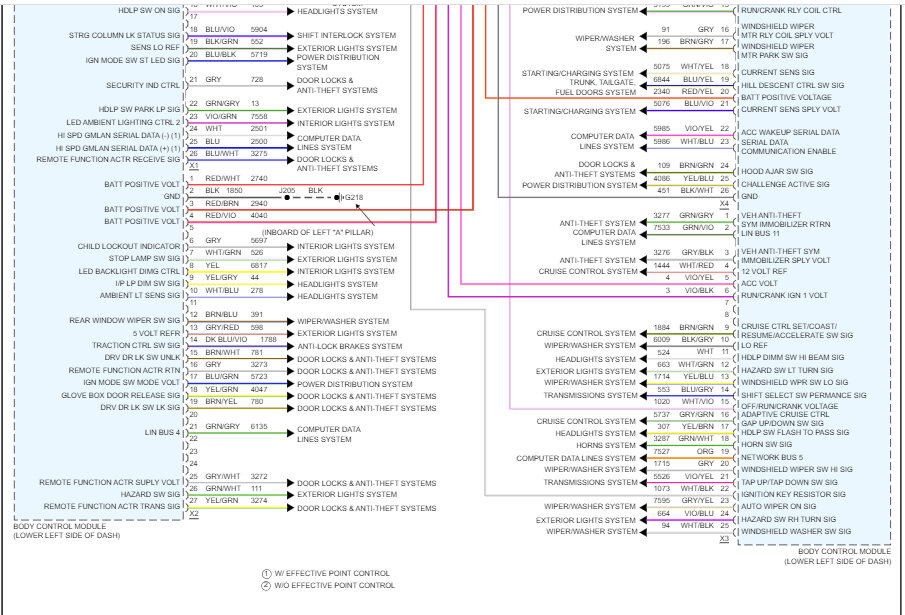

As far as the information, the first pics are the wiring schematics. I had to cut each pin in half to make them readable.

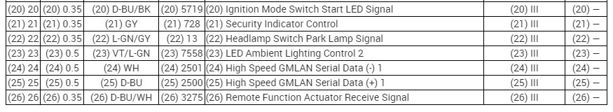

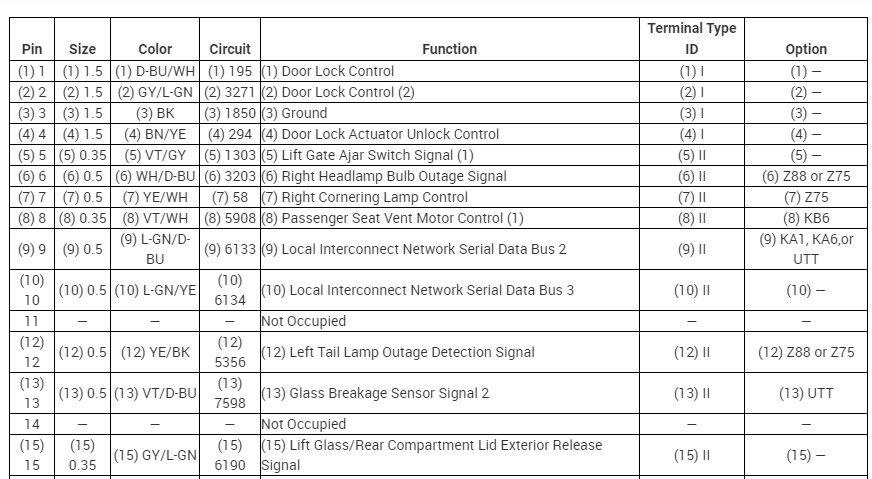

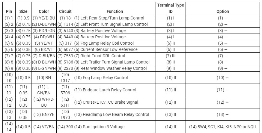

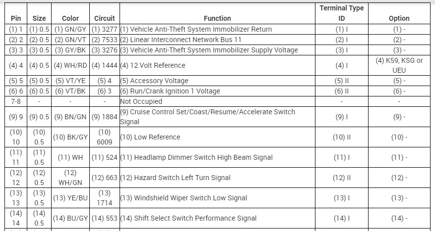

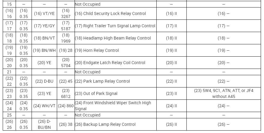

The remaining pics are the connector views and what each pin is used for. Note: There are several.
Let me know if this helps.

Joe, I’m sorry sir. My SUV is a 2015 GMC Yukon Denali non 4x4. It didn’t give me the option at first. Thanks

No problem whatsoever. The only thing is this. I only have the wiring schematic for the BCM for this model and not the pinouts. The pin numbers are indicated in the schematic but not the actual connector layout.
