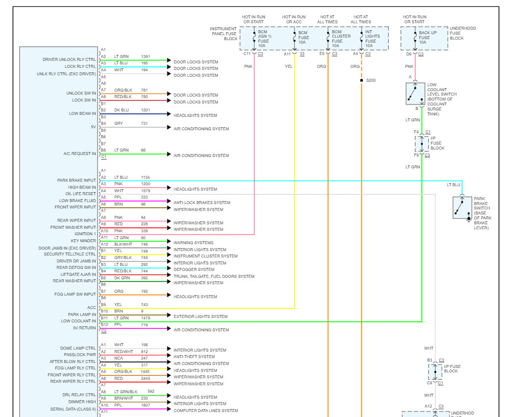

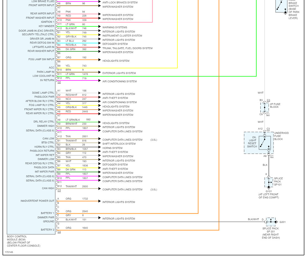

I need a detailed picture guide connecting the wiring harness back into the BCM.

Sure, here is the BCM wiring diagrams as requested and I have included a guide to help you test the connections.
Check out the images (below). Please let us know if you need anything else to get the problem fixed.
