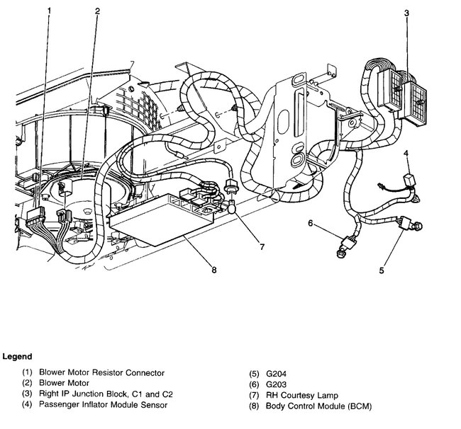

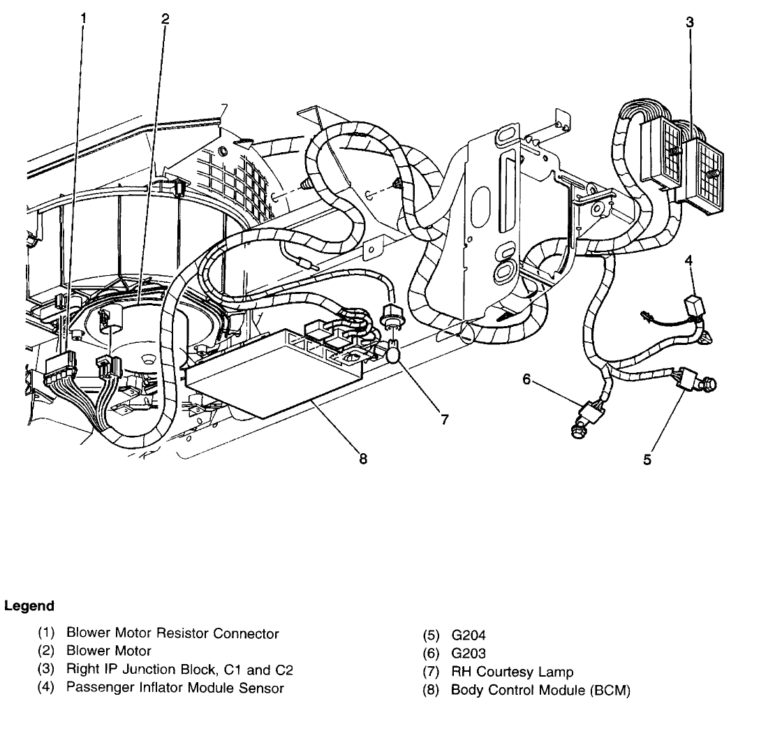

Where is it located?
Aug 9, 2017 at 8:22 AM
STEVE W.
  • 15,349 POSTS
Under the passenger side dash panel. Remove the sound deadener (if it has one) and the BCM will be visible mounted to the bottom of the HVAC case.
It is not a part that can just be replaced, any replacement has to be programmed to your vehicle for it to work.
What is the issue you are having?
