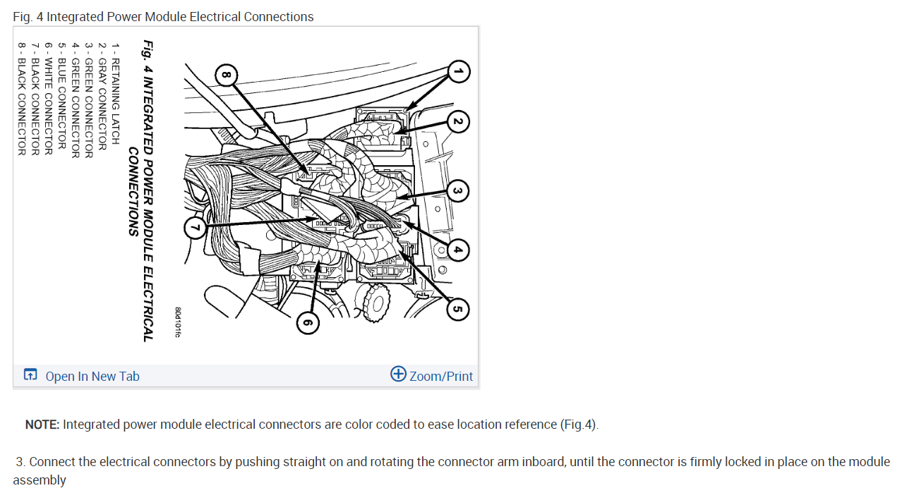

Hi, does anyone know where on the truck listed above (1500 SLT, RWD) the central timer control is located?

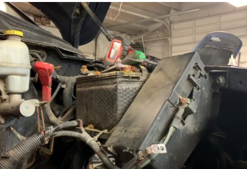

It is located to the left side of the steering column. I've attached a picture below of its description. Let me know if you have any further questions. Hope this helps and thanks for using 2CarPros. I've also attached pictures of the body control module location.It's mounted under the integrated power module under hood.It's the silver box.

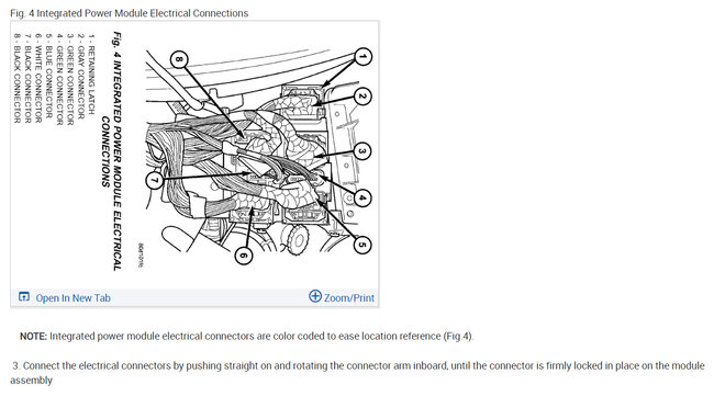

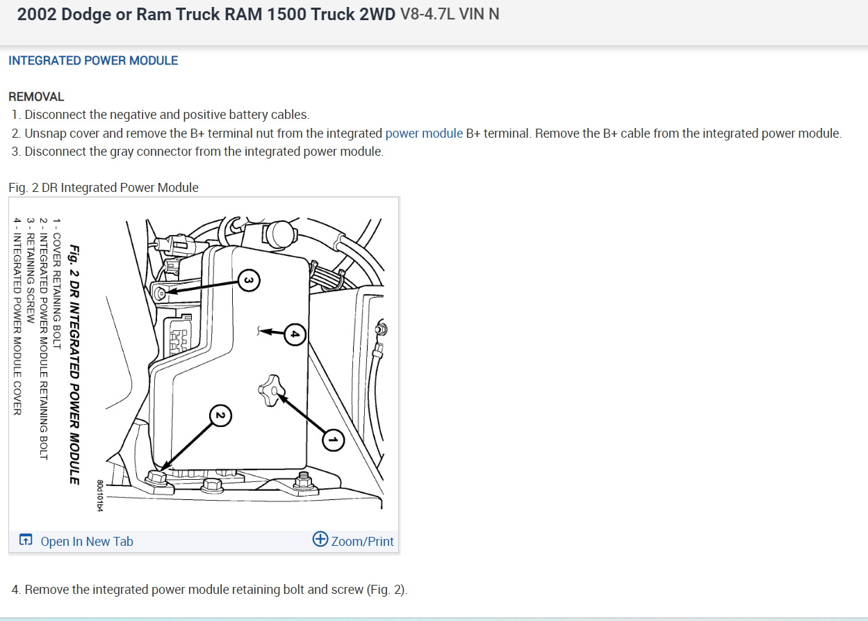

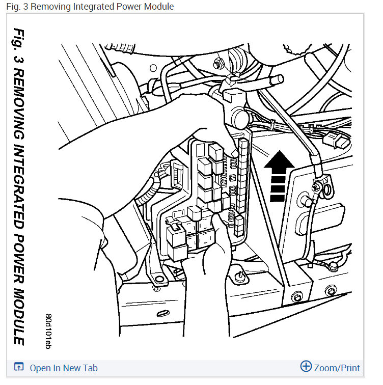

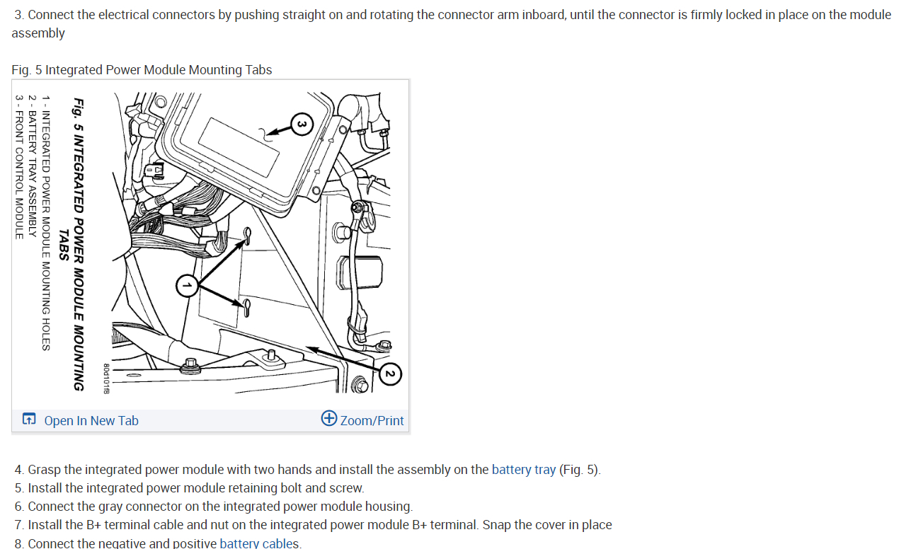

The central timer module is integrated into the TIPM (IPM), which fail often in these trucks but they are easy to replace because they self learn. Here is how in the images below. Check out the images (below). Please let us know what happens.
