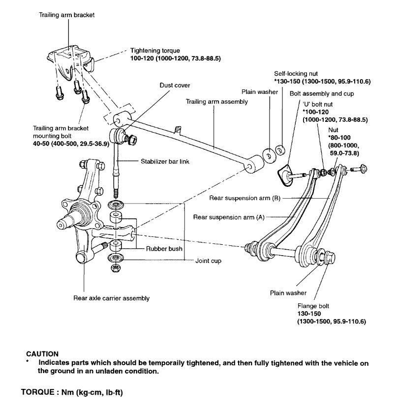

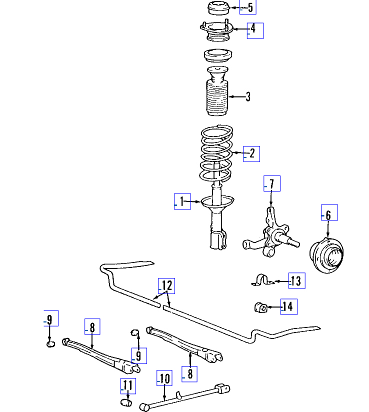

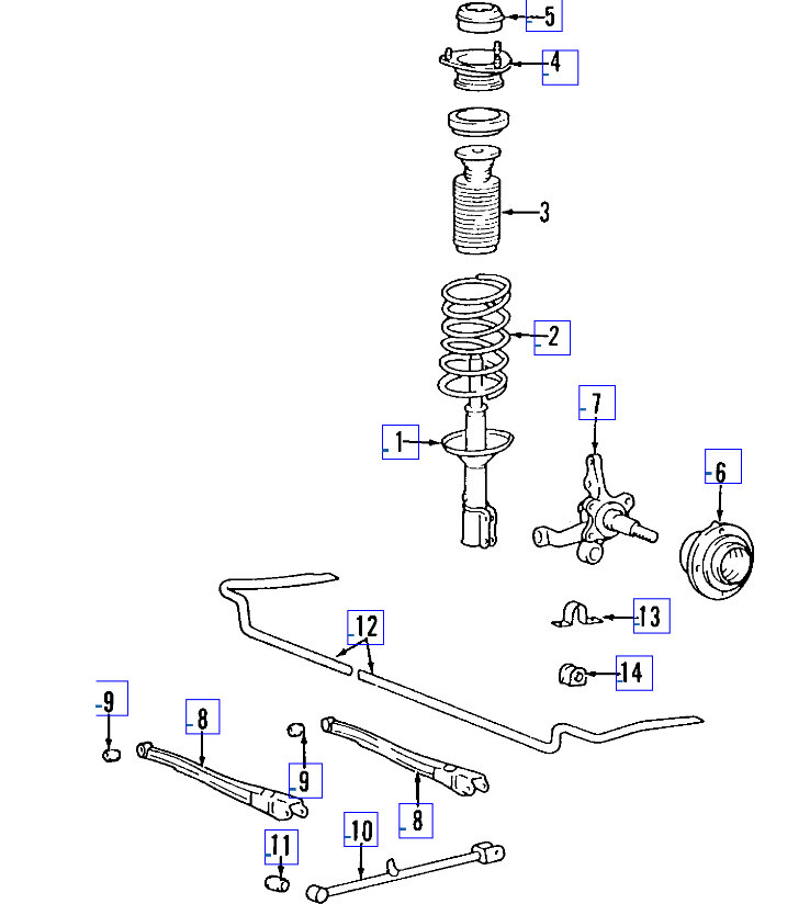

Can you upload images of what you are talking about? This is kind of difficult to guess at, in the meantime here is an exploded view of the rear suspension so you can see what parts there are. Check out the images (below). Please upload pictures or videos in your response of any problems so we can see what to help you with.
