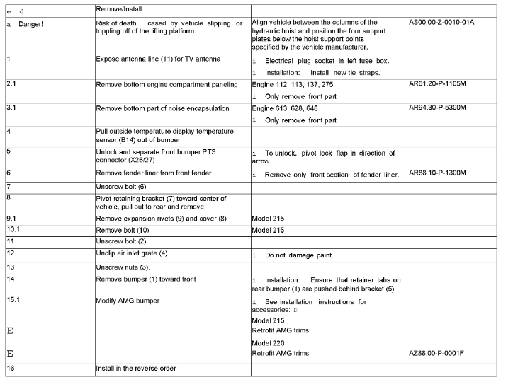

I would like to know how to remove the front bumper so I can replace it with a new one.
Jul 2, 2024 at 9:12 PM
  • 110,193 POSTS
I assume you are referring to the front bumper cover. If that is not correct, let me know.

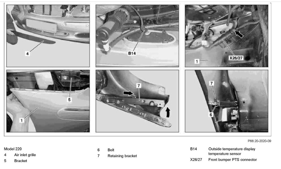

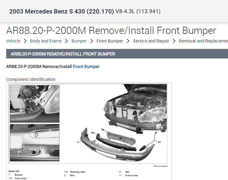

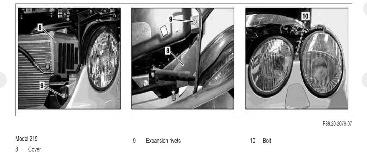

If you look below, I attached the directions from my manual. Note the directions follow the part diagrams.
Let me know if this helps.
