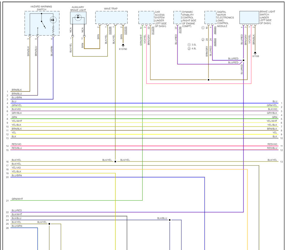

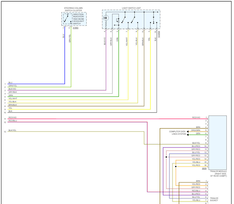

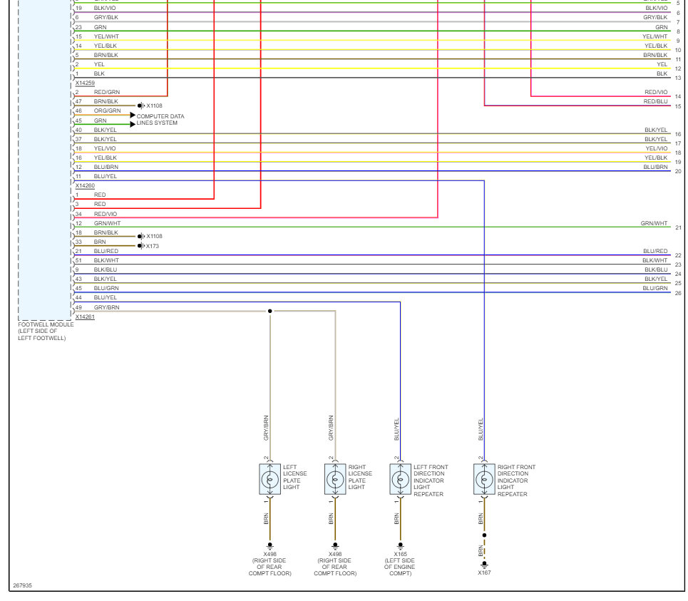

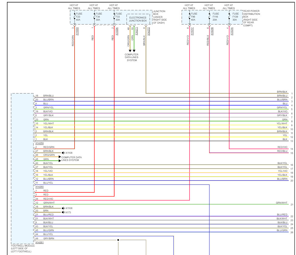

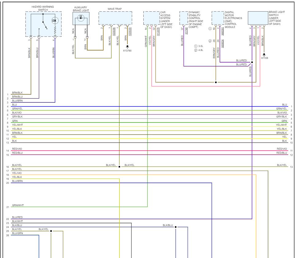

The blinker signal for all blinker lights comes from the footwell module. I would check the fuses here is a guide to help you and the blinker wiring diagrams so you can see how the system works. If the fuses are okay, please check the ground of the bulb socket. This guide can help. The first wiring diagrams will show you which fuses to check.
https://www.2carpros.com/articles/turn-signals-not-working-blinker

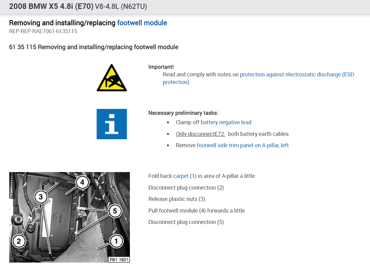

If the ground is good, I would replace the footwell module. I have left instructions for that as well; you can get a preprogrammed unit by searching Google or Ebay. Check out the images (below). Please let us know what happens.
Apr 24, 2023 at 10:33 AM
